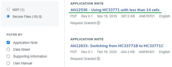

TomasVaverka
Hi Roberto,
I would recommend you to take a closer look at our AN12536 which explains how to arrange LPF for MC33771/MC33772 when using less than 14/6 cells.
You can download the AN12536 from this website.
Please make sure you are signed in to nxp.com and select Secure Files. If you do not see the AN12536, please click on "Request additional access" or edit your secure access rights by going to My NXP > Profile.
In case of any problems with downloading the AN12536, please contact directly our DocStore Support team via support.docstore@nxp.com
Tomas

robertoschembar
Hi Tomas,
Using the Filter type B for MC33771 (fig 2 in AN12536) is OK for Safety with MC33772C?
Roberto
2,080 Views
TomasVaverka
Hi Roberto,
Yes, please look at Fig. 3 of the same application note: it is aimed at MC33772B, but can be used for the MC33772C as well.
