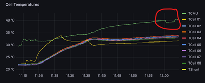

During normal operation of the MC33771C we sometimes see sudden temperature reading drops on its internal temperature sensor that we cannot explain. Do you maybe have an explanation for this?

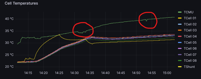

From a recent production batch, I found that 13 out of 380 products showed similar dips in temperature measurement of the MC33771C. All dips occurred in an otherwise steady environment (constant current charging, constant current discharging, idle). No similar dips can be seen in other metrics from the MC33771 (cell voltages, balancing, other temperatures etc).
In terms of chip activity, our algorithms run the same polling of information all the time. I do not expect temporal changes in behavior that could have such a significant effect in chip temperature.

The temperature of the IC can be affected by the cell balancing activity. Perhaps some SW routines are activating/deactivating the CB.

We have, however, verified that the chip is not balancing using the CB_DRV_STS
