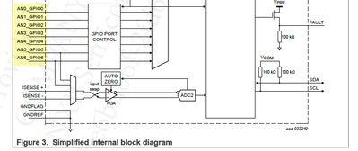

I am diagnosing cells from an electric-vehicle battery.
I use your software and cannot understand what kind of data is in the program. Do you have a more detailed description of what kind of data is displayed in the table?

The BMS view displays all measurements of all clusters and provides an overview of the whole BMS.
Those are the general purpose analog inputs and those values (ANx) refers to the MEAS_XXX registers.
Those registers contain the measured values as a result of on-demand conversions. Note that the cyclic conversions leave no trace in these registers, as they are only used to update the OV/UV/OT/UT flags and other status information.
You may find further information at chapter 11.36 from the MC33771C datasheet or chapter 11.35 from the MC3371B datasheet.
