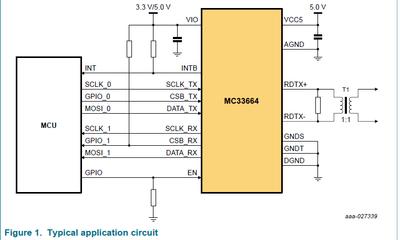

Dear Community,
my MCU use UART interface. I would like to convert the UART signal from the MCU to SPI. Would this be possible with an UART to SPI bridge such as SC16IS7xx or similar? But MC33664 requires two SPI interfaces, is there another suitable bridge for this?
best regards,
Patrick
825 Views
JozefKozon
Dear Patrick,
we have MC33665A SPI to TPL, CAN FD to TPL or UART to TPL transceivers. You need to choose MC33665ATU4AE for UART to TPL transceiver, then you don't need an SPI to UART bridge. Please refer to the MC33665A datasheet.
