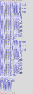

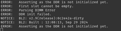

Hi all,
I am trying to follow this application manual (https://www.nxp.com/docs/en/application-note/AN12270.pdf) in bringin up a board using DRAM. I have made the neccessary changes for my board, the NXP LS1046ARDB board. But I am getting this message:
Any tips on how to fix this?

Rinke
Thanks for the pdf. That already helps some!
Ive gotten a bit further.
This is what I am getting upto. Ive added some print statements to show how far its getting. It is failing during writing u-boot to memory. I am not sure why. I am using the default ddr-init-ls1046rdb.tcl that is mentioned in the tutorial. I can test the read and write to ddr with the mentioned functions and that works fine. I am building u-boot.bin from https://github.com/nxp-qoriq/u-boot. Following these instructions: https://community.nxp.com/t5/Layerscape-Knowledge-Base/LS1046ARDB-How-to-update-U-Boot-binary-on-SD-...

Rinke
Are you able to help me with the last step? I am not sure what I am doing wrong.

Rinke
When looking at the debug output:
