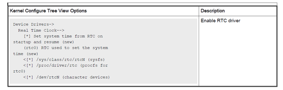

LS1043 Power-On Self test :
RTC: failed
Some tests FAILED.
--Failure logs--
RTC:expected seconds = 498,actual = 43
ERROR:POST returned 0x80

You could test RTC in Linux.
Please compile Kernel with RTC driver enabled.
In addition, enable RTC device driver similar as the following.
root@localhost:~# zcat /proc/config.gz | grep CONFIG_RTC_DRV_PCF85363
CONFIG_RTC_DRV_PCF85363=y
In dts, configure RTC similar as the following.
&i2c0 {
status = "okay";
rtc@68 {
compatible = "pericom,pt7c4338";
reg = <0x68>;
rtc@51 {
compatible = "nxp,pcf85263";
reg = <0x51>;
In Linux OS on the target board.
root@localhost:~# hwclock -s
date
root@localhost:~# date
Mon Jul  1 14:02:39 UTC 2030

Is the chip bro?ken? Is there a solution to this problem
