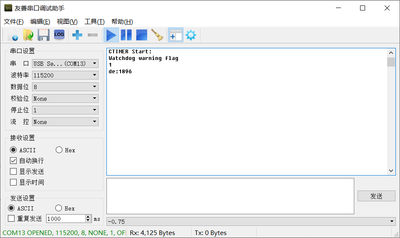

I wonder how to output a printed float in JN5189's JN-AN-1243?
It now prints blank and cannot print floating-point numbers.
