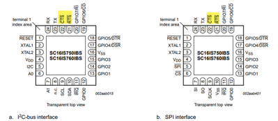

I would lie to use SC16IS750IBS as a bridge from I2C to UART.
The UART device has only TX/RX ports (~RTS/~CTS not included in the device)
 Is it will works without the ~RTS/~CTS signal connection?

Hello Avi,
I hope all is great with you. Thank you for using the NXP communities.
Please review the image below. You may find the pin configuration of your device. The pins mentioned are the 21 and 22.
Please review the datasheet for further information.
Could it be that I am misinterpreting your question? Are the pins available in your device?
I hope this information helps.
