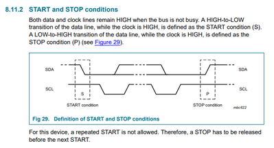

Hi Daniel,
both cases described by you are possible. Depends on, if the slave allows repeated START. Please see a section 8.11.2 in PCF8523
In case of PCF8523 the STOP bit has to be released.
Please see a section 2.1.2 in slva704 attached.

JozefKozon
Dear Daniel,
thank you for pointing out to the statement in the page 47. Seems, that one of the statements in the PCF8523 datasheet are not completely correct. Either the one on the page 45. "For this device, a repeated START is not allowed. Therefore, a STOP has to be released before the next START." or the one on the page 47. "data transfer is terminated by sending either the STOP condition or the
START condition of the next data transfer."
I will report it to the application team.
Regarding the PCF85102C, the repeated start seems to be allowed.

JozefKozon
Dear Daniel,
the application engineer confirmed, that repeated start is not allowed for PCF8523. Please see below.
DESCRIPTION
The statement in page 45 is correct which repeated START condition is not allowed to be used in I2C communication with PCF8523."
The statement is page 47 should be changed as In the write mode, a data transfer is terminated by sending the STOP condition, and then following the START condition of the next data transfer”
