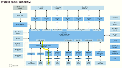

E-John
Dear Bulat,
Thanks for your explanations. There is a system diagram below(from some NXP documentation)
If MCU want to output ethernet to general RJ-45, starts from PRE-MAC0 -> Ethernet switch(SJA1110A) -> Ethernet PHY 1x -> 1000BASE-T -> RJ-45.
What are these Ethernet PHY 1x and 1000BASE-T supported and recommended by NXP?
E-John
2,546 Views
Bulat
We do not have a list of recommended PHYs. You can treat as "recommended" the PHYs used on our reference boards.
Block diagram seems to be related to the S32G-VNP-RDB2 reference design board. Please visit its home page, section "Design Resources" provides  schematics of the board where all mentioned PHYs are explicitly listed:
https://www.nxp.com/design/designs/s32g-reference-design-2-for-vehicle-network-processing:S32G-VNP-R...
