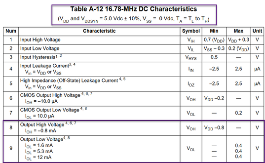

We choose the controller MC68HC16Z1CFC25 for our product. I need source and sink current of the controller so that it will be useful for my project. How to get these values from the datasheet?
It would be very appreciated for the answer.
773 Views
danielmartynek
Hi Selvameena,
This is specified in the datasheet:
https://www.nxp.com/docs/en/data-sheet/MC68HC16ZUM.pdf
In the table below, you can find the sink/source current and the expected max. voltage drop from VDD/VSS at the corresponding current load.
