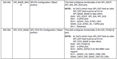

in rcw_1600_qspi.rcw file I have added below mentioned code
SPI_EXT=0
SPI_BASE_BASE=0
SPI_PCS_BASE=0
I am booting from qspi flash (not SD Card boot) and SPI_PCS3 pin is multiplexed with other  functionality, do I need to set any switch configuration?

When we boot from SD Card SPI_PCS_BASE=3 then only SD Card booting will work properly and SPI_PCS[0:3] lines cannot be used for SPI Chip Selection lines. If we want to use SPI_PCS[0:3] lines for SPI Chip Selection lines then SPI_PCS_BASE=0 but SD Card booting won't happen.
Can you please suggest is there any method SPI_PCS[1:3] can be used for SPI Chip selection lines when we boot from SD Card?

Can you please suggest, after booting up, do I need to change any BRDCFG bits to bring out SPI_PCS lines from MUX which was controlled by CFG_MUX_SPI line which was connected to CPLD?
I am booting from QSPI 1 and my boot partition and rootfs in emmc.

Basically these pins are not able to access for probing, because both ICs are BGA ICs. Only access those test points.
I did some experiment looks like SPI is working but problem is CS is not coming out due to multiplexing these lines with eMMC lines.
I need to test SPI in different manner. I need to configure eMMC for 4 bit bus width mode and by using Qixis command I need to switch SPI_PCS lines to out to test points.
Can you please help me where I need to change in the code to make eMMC bus width for 4 bit at boot mode and linux mode.
