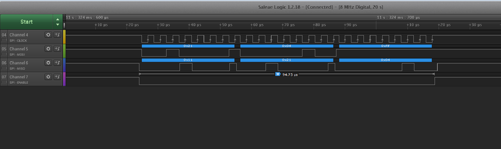

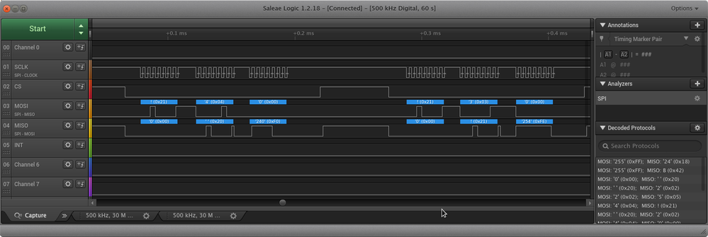

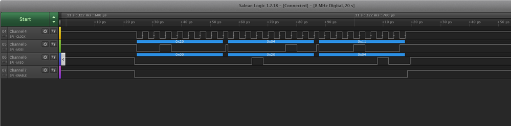

I am trying to write and read the internal registers of the SPI_I2C bridge (SC18IS600) by referring the commands given in the datasheet. But when I send the commands for writing the data byte in a particular internal register and then read the same register, I am just getting the data which has been sent over the MOSI pin shifted by 1 byte on the MISO pin. I have attached the screenshots of both write and read commands tested using logic analyser.Can you please help me regarding this issue and let me know if any other ways are there for reading or writing the internal registers.(I have also verified all the connections according to the datasheet of the MPC uC and SPI_I2c bridge and also with the configurations). Let me know if any initial configurations are to be done for writing and reading to the registers.SPI_I2C_SC18IS600_write.PNGSPI_I2C_SC18IS600_read.PNG

I was having the exact same problem.  Thanks to Michael Thompson for leading me to the first issue which was the minimum of 8 uS (Tspiclkw) between each byte.  But things were still not working for me but again thanks to Michael Thompson I read some of the other specs.  Namely the CS high timing between each SPI transaction.  That seemed to be the missing piece for me as I am now able to read the Internal Register Values:
Here I am reading I2STAT and I2CTO which appear to give the correct values.

mikailaltintas
Thank you Ted. I solve this problem. I see that data pin timings is important. It must be stay state of last send bit at least 2 clk time. Other ways IC can't dedect it.

MikeThompson
For other people who may run into this issue, I opened a support case with NXP and they were able to resolve it.  The root cause was not honoring the unusual timing between SPI bytes required by the SC18IS600.  As indicated in table 15 on page 20 of the datasheet, the clock must be held high for at least a minimum of 8 uS (Tspiclkw) between each byte being transferred over the SPI bus.  In my case, I was using DMA transfer of data over the SPI bus and each byte was back-to-back with essentially zero timing between the bytes which led to the situation where the bytes were just being echoed back.  Honoring the timing as specified in the datasheet resolved the issue.

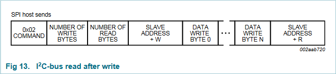

darioarias
Hi Tom,
Have you tried the I2C-bus read after write? This is command 0x02 and this one allows you to write the slave address and the specific EEPROM address and then it will issue a repeated start condition to read the content from that address.
This is the format to perform this command
SPI-MOSI output should look like this
     RByteCMD - NWByte - NRByte- I2CAddr - EEPROM_addr - I2CAddr
     0x02 -             0x01 -         0x01       0xA0 -       0x01                  -  0xA1
