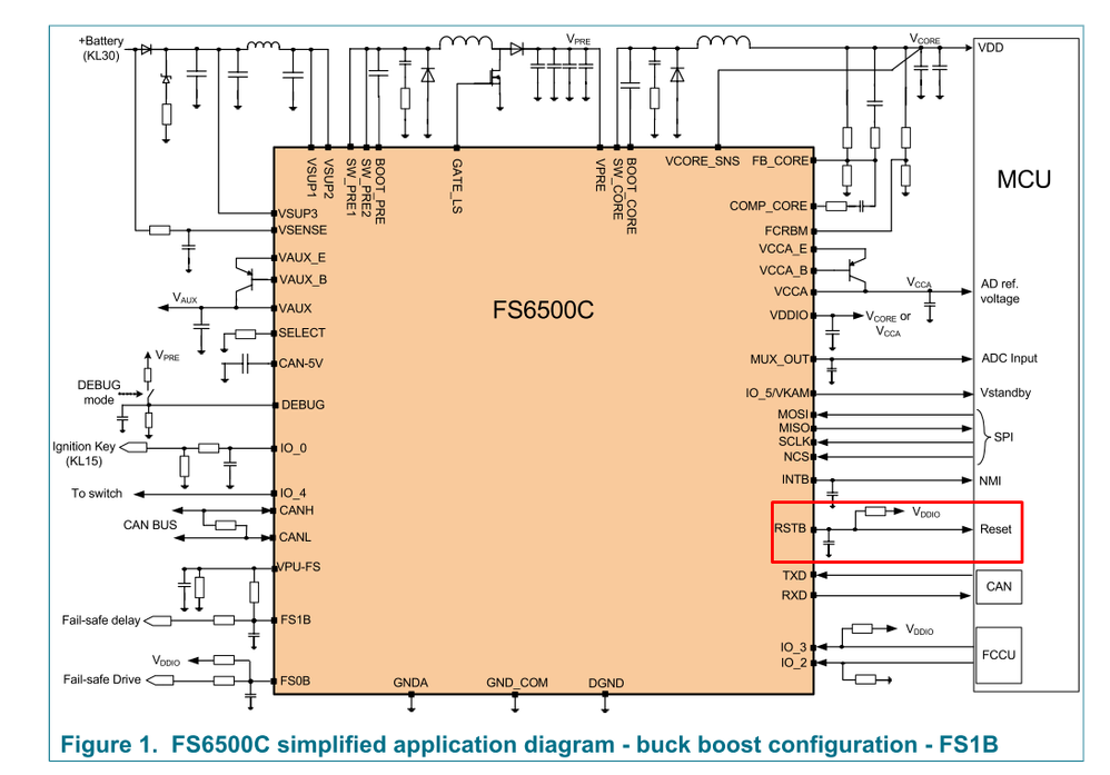

[Gunghui.Niu] can I interpret it as even set IO_23_FS=0 at FS6500 init, then at nomal WD inject FCCU fault ,SBC still can be reset?
In common use case SBC reset and MCU resets are connected. The resets are bidirectional, so when either of the device experience reset it will also trigger reset on other device.
Please refer to datasheets
[Gunghui.Niu] when I set IO_23_FS=1, I also set NCF_E[n].R=0(n=1,2,3)register to disable FCCU fault transition  from normal state to fault state at FCCU Init, it's mean no FCCU error,but you can check my reply at Data 2019.11.11 6:39, SBC still can be Reset
The reset source is not necessarily FCCU. I can be any other event. You can see the reset source in MCU in RGM (FES and DES) registers once reset is executed.
regards,
Peter

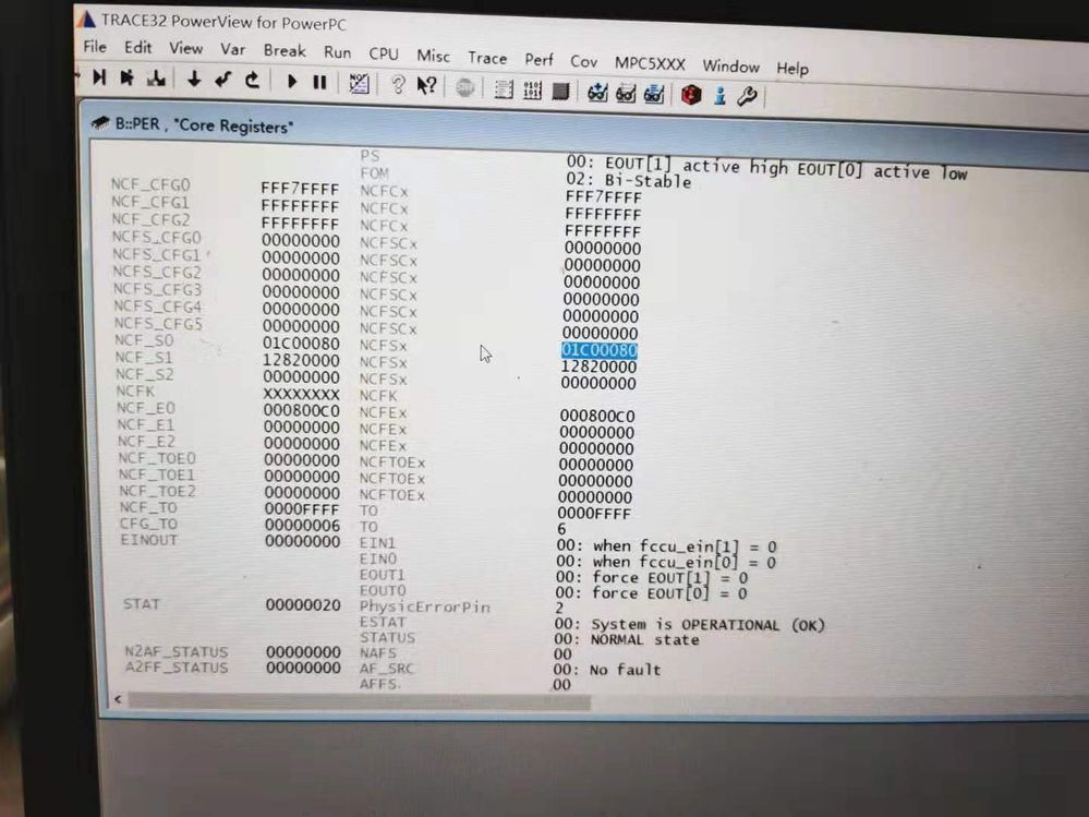

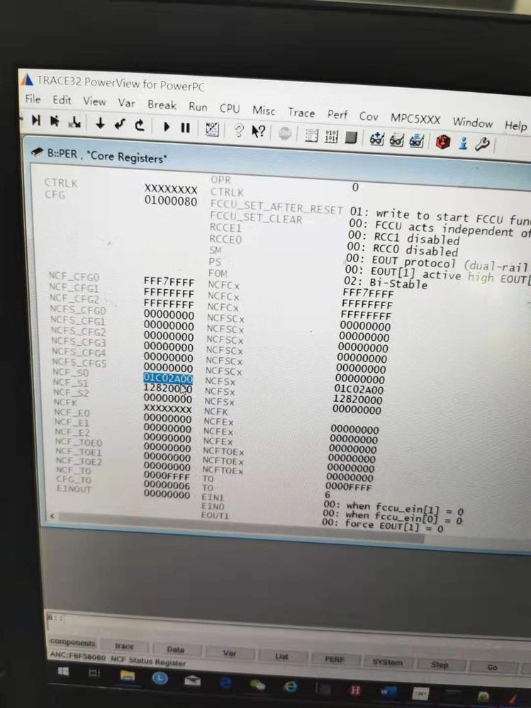

1: when I inject NCF Index=7 fault, but I also set FCCU_NCFS_CFG0=0 to  set No reset reaction , why still can be reset?
bellow is the FCCU register

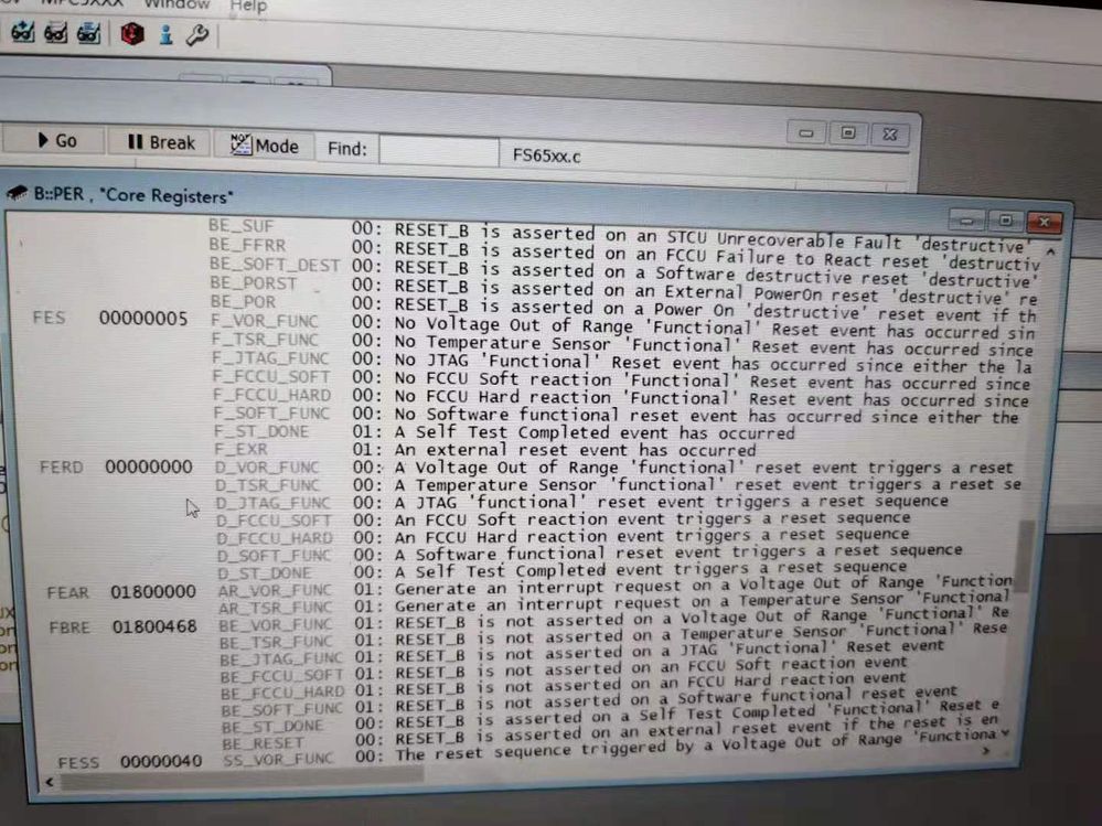

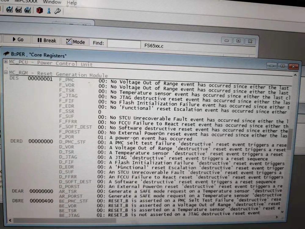

2:when set IO_23_FS =1,I see the reset source FES, DES and FCCU,they show as below.it's sames just power reset, so it's strange what's make continuous reset.
4,765 Views
petervlna
The reset is triggered by FOSU because you enabled fault and didn't too any action until FOSU watchdog expires. This is safety mechanism for case the fault servicing routine is stuck.
As you can see from FES the source is external reset -> SBC chip or debugger.
I guess it is SBC who make continuous resets.

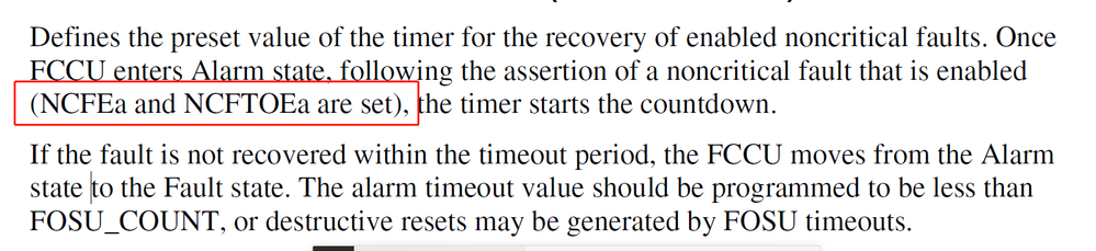

1: for FOSU reset
but I set NCTEOE=0 for FCCU moves into the FAULT state if the respective fault is enabled not to Alarm State, so why FOSU still can work?
2:why once I set IO_23_FS then will be have external reset, it's very stranger. from the register monitor there is no clue.I don't know how to solve this issue.
4,765 Views
petervlna
FOSU cannot be disabled. It works always. It is FCCU supervisor unit. Watching its correct execution.
IO_23_FS mus tbe set after micro is configured. Once micro is configured it will take care of level on EOUT lines. If there is no fault the SBC wont trigger reset.
Just make sure that once you configure FCCU you have on EOUT no error before you move your SBC from debug state to normal.
To be honest I am still not sure how do you connect uC and SBC and if you used pull resistors correctly.
regards,
Peter

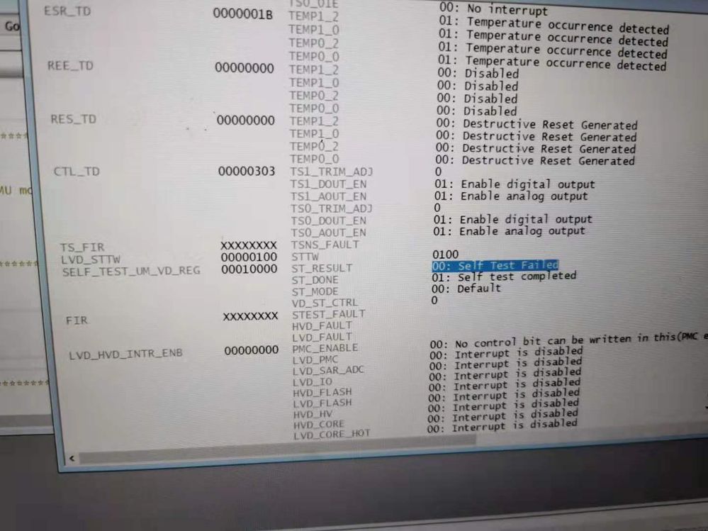

niugh0928
Hi Peter:
Happy new year
as you said befor I found that LVD self test if not passed. is that the case for SBC reset?
4,765 Views
petervlna
Just do the measurements on scope to see when the drop occurs.
Most probably your SBC is not able to deliver required current in required time.
LVD fail will trigger reset. As you cannot any longer trust micro execution.
You can also replace SBC by power source to see if the problem is gone.
regards,
Peter

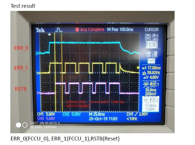

4,765 Views
niugh0928

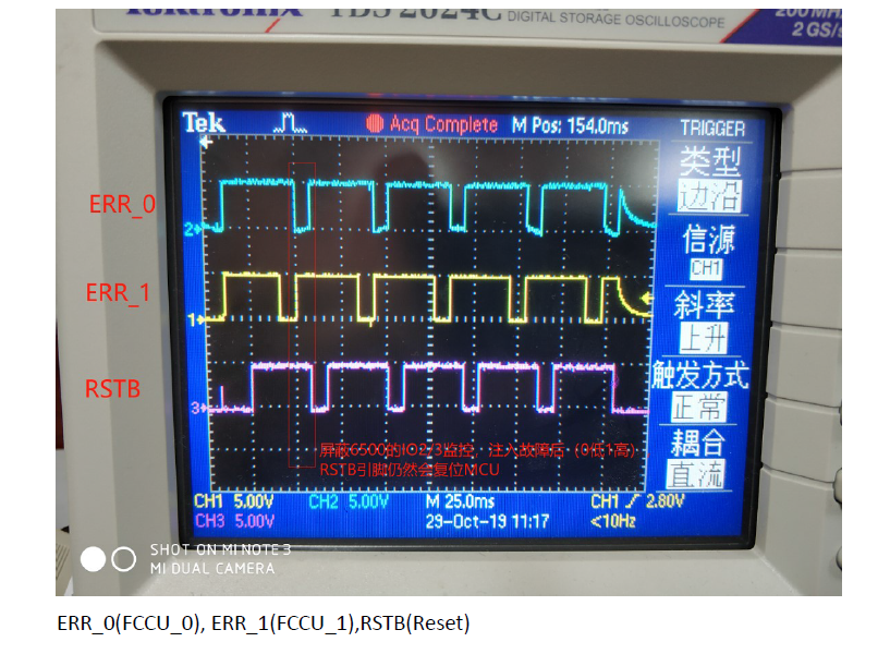

Hi Peter we use mpc5745r.
I attach my test result for you refer
Test case 1:
Enable IO_23_FS=1 , then set NCF_E[n].R=0(n=1,2,3)register to disable FCCU fault transition  from normal state to fault state
test result analysis: according to bi-stable, at   normal phase RSTB assert low, its not the right action.only at error phase RSTB should be assert low
Test case 2:
Disable IO_23_FS =0, set register FCCU.NCF_E[0].B.NCFE7 = 1, after first WD, set FCCU.NCFF.R = 7 to inject FCCU fault
test result analysis: according to bi-stable, As we know just when IO_23_FS is enable, and refer to bi-stable at error phase RSTB should be assert low。
But the result is we didnt set  IO_23_FS=1 when have FCCU fault ,RSTB still can be assert low
4,765 Views
