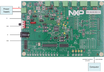

Hi I have a question about how to properly configure the FS26AEEVM using the related GUI.
Currently I power up the device according to the User manual instructions in section 6, but rails do not output to the voltage value I write using the mirror registers tab. For example, no matter how I set the registers VPRE always outputs 5.4V after power up.
Please advise how to correctly configure rail voltages using the associated GUI.

3. Could you please make sure that the FRDM-KL25Z board is properly flashed with the proper BOOTLOADER? You can find such file at \GUIs\NXP_GUI_PR\NXP_GUI_PR_6.0.0\2 - MCU\1 - KL25Z_FW
4. Could you please confirm that your device is within the configuration below? Please make sure that you connect the Windows PC USB port to the KL25Z USB side of the Freedom board
5. Is the board detected by the GUI?

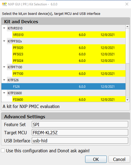

1) Yes I am already using the "NXP GUI for Automotive PMIC."
2) I only have FS26 listed as a target on the GUI not FS26-CO. Is that an issue?

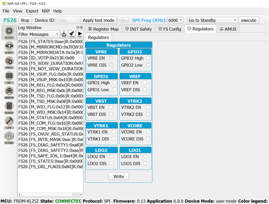

3) How am I meant to access the file location you provided? On my end it is just a file path with no link. Although, I do not believe the FRDM-KL25Z board FW is the issue. I have been able to enable/disable rails via the Regulators tab in the GUI (shown below). To me this indicates that I can successfully communicate with the FS26 from the GUI.
4) Yes the device matches the configuration you show. I have confirmed I am correctly connecting to the KL25Z USB port and not "OpenSDA."
5) Yes it is, see image below showing FS26 in green and the Regulators tab mentioned above.

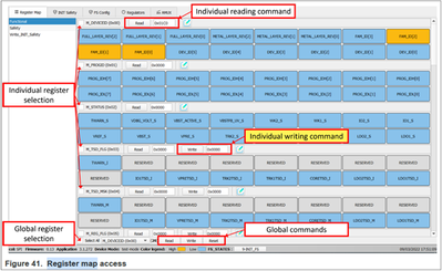

Have you tried to write to the Register maps directly in order to modify the output voltage?

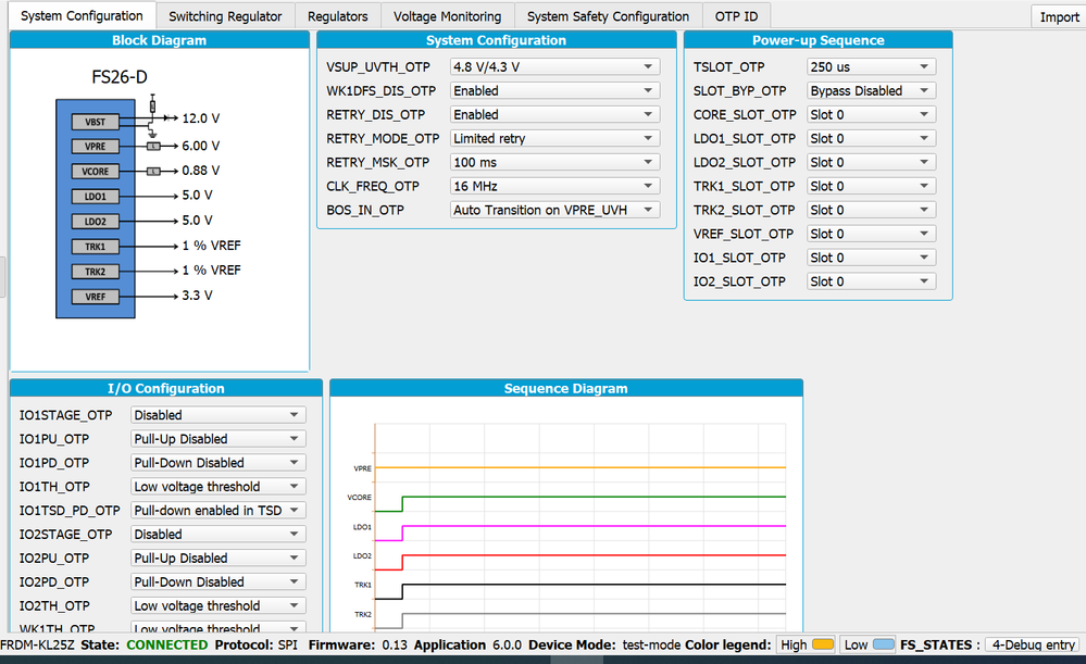

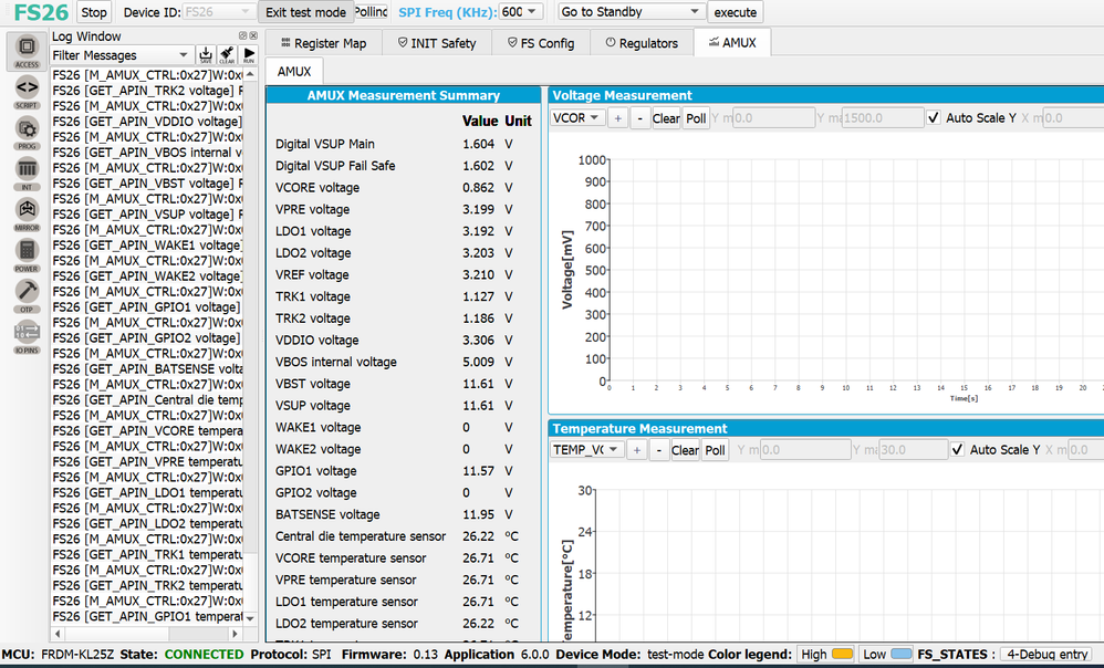

I have been attempting to use the OTP tool. I configure my desired settings in the OTP tool, saved them using the export tab then emulate that OTP configuration using the script tab. To do this I put the device in debug mode run the OTP file then flip SW6. At this point all the outputs turn on, but still not at the desired output I set.
VPRE outputs 3.2V instead of my setting of 6V. Are you able to assist in explaining this behavior?
I have attached the main configuration tab and measurements summary as reference.

2)I currently do not have access to UM11812. I requested a few weeks ago, but NXP.com says my request is still being processed. My current power conditions is just a 12V supply connected to J1 VBAT connector and my PC connected to KL25Z USB port.
3) I follow these steps and observe the same behavior I described in my previous reply. Once I run my OTP settings using the script command window the device only outputs 3.2V no matter the voltage I set in the OTP tab. Is this behavior expected?
