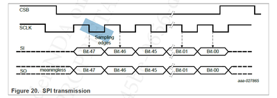

according to the picture below from the  MC3772C.
My SPI driver does not meet the condition of the clk input low before the CSB is asserted.

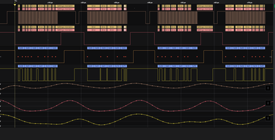

hajianik
Senior Contributor I
Hi Josef,
Thank you for your response.
In below screen shot  the channel 1( Brown) is the clock  and channel 4 (yellows) the MOSI .  as you can see by the red vertical line , lines up with the trailing edge of the clk and the Mosi( rising edge)

hajianik
Hi Josef,
Even IF I go with phase1 does not change anything I still get a zero response to all my write and read requests.
CAN YOU PLEASE  ANSWER A VERY SIMPLE QUESTION RATHER THAN REFER ME TO DATASHEETS. The other day you mentioned my data for assigning CID is wrong and I asked you( with detail description of the format of the packet ) what is in error? YOU DID NOT ANSWER THAT and rather ask me about a more focused view of the SPI transfers ,which I'm providing in this post. I will ask this second time and please answer to this specific question and don't send me on a goose chase. to assign a CID , I'm sending the following packet , if this is in error ,please indicate the correct packets to be sent:
0x01, 0x01,,0x01,0x00,0x02,0x28
Again  from the left :  the 1st 2 bytes are the data(assigned CID) , 3rd byte is the address, 4th is the unassigned CID,5th is command byte(write), 6th is the CRC.
I've been working with lots of your colleagues and in a situation like this , they just do a simple test on their own I'm not the one to tell you what to do, but at this point ,it seems to be the best solution.

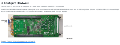

JozefKozon
Hi Koorosh,
the recommended MCU board for the FRDM33772CSPEVB is S32K144EVB. Both boards are hardware/software compatible. Please consider purchasing the recommended board. You can directly mount the FRDM33772CSPEVB on top of the S32K144EVB and use the GUI, and software on the FRDM33772CSPEVB page

JozefKozon
Hi Koorosh,
I apologize for my inconsistency. Yes you can use any master you want to write and read from the MC33772C registers. Please share a scope from the SPI lines. I would like to check if you have correct SPI mode. Please refer to the Figure 20. in the MC33772C datasheet. The CPOL should be 1, the SCLK high on Idle and the CPHA should be 0. Data changed on SCLK rising edge and sampled on SCLK falling edge.
You have send the correct 48bit format, but with incorrect data. At first you need to initialize the MC33772C with a new Cluster ID. You need to send a write command with a default CID=0b00 0000, and assign a new CID. Please refer to the sections 11.2 and 10.4.2 in the MC33772C datasheet.

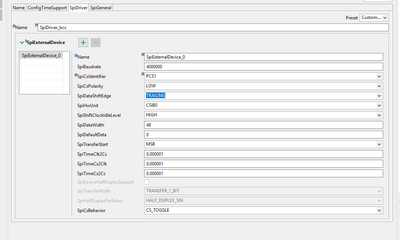

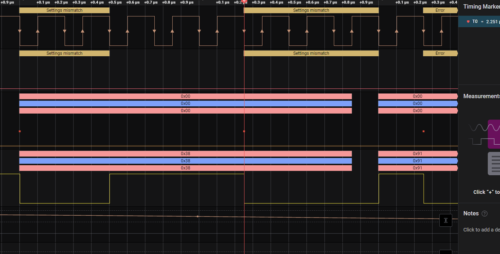

hajianik
Hi Josef,
the first screen capture below shows the SPI CONFIGURATION.
CLK:IDEAL HIGH
Phase 0 trailing edge. actually I tried leading edge and did not make any differences
the screen below shows scope capture:
Where brown is the clk , Red CS, ORANGE MISO, Yellow the MOSI. I know the clk is wearied but in my past experience with NXP drivers, it's been like this. anyways the clk appears normal during the cs assertion at a frequency of 4mhz.

JozefKozon
Hi Koorosh,
please confirm, that you have the MC33772C full datasheet. When initializing the new MC3377xx, you need to follow the format in the section 10.1. in the MC33772C datasheet. Please share more focused view of the SPI waveforms. I need to check the timings of the SCLK and MOSI. If the CPHA is indeed 0.
Please note: "Unlike the read command, for which MC33772C responds with data, the write command
does not generate any response."
