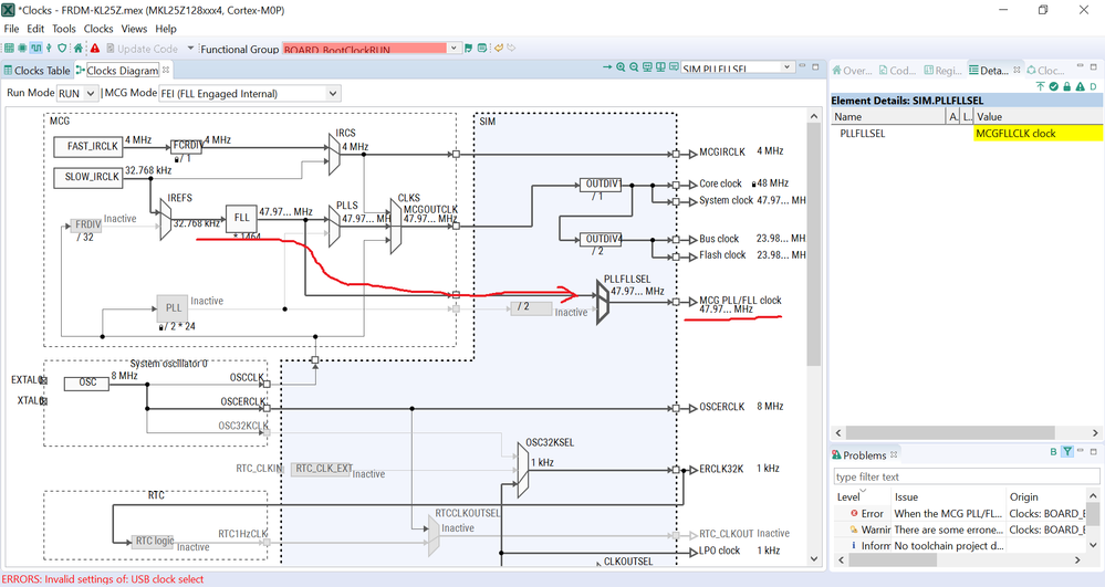

Please, what source clock should I use for UART0 in polling mode on FRDM-KL25Z?
I suppose that should be MCGFLLCLK clock or MCGPLLCLK/2. If so, which on of them?

It is MCGFLLCLK. UART0 clock source could be the MCG PLL/FLL clock. You can see in to picture that there is no /2 divider in the path.
