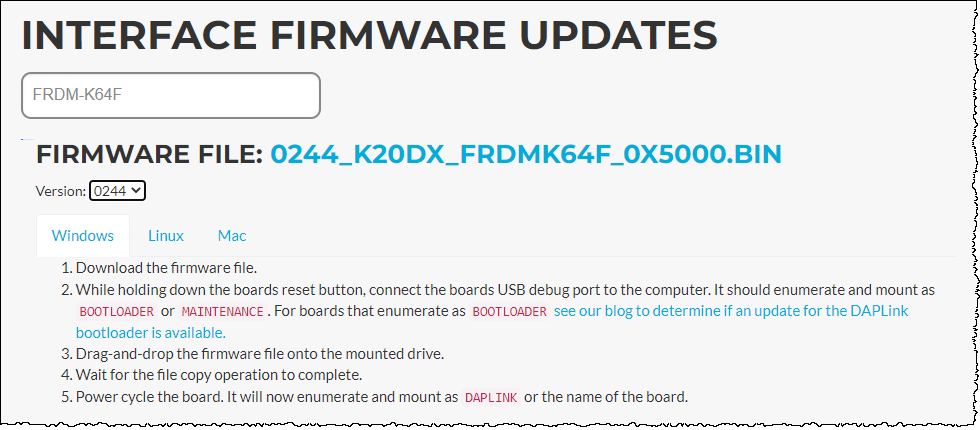

Did you follow the "Step 5: Install an interface firmware application" and install the 0244_K20DX_FRDMK64F_0X5000.BIN?

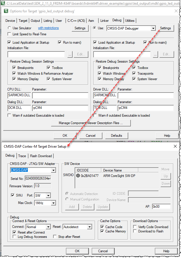

Then you should be able to see CMSIS-DAP debugger in Keil MDK.

Yes, I have followed step 5 but I installed version 254.

Please try to install 0244 instead of 0254.

Please try restarting the computer, only open Keil MDK, and try to select CMSIS-DAP as Debugger.
Have you tried to install J-Link firmware application, and then try to use J-Link to debug in Keil MDK?
If it still doesn't work, I am afraid to contact ARM's technical support about CMSIS-DAP and Keil MDK.
