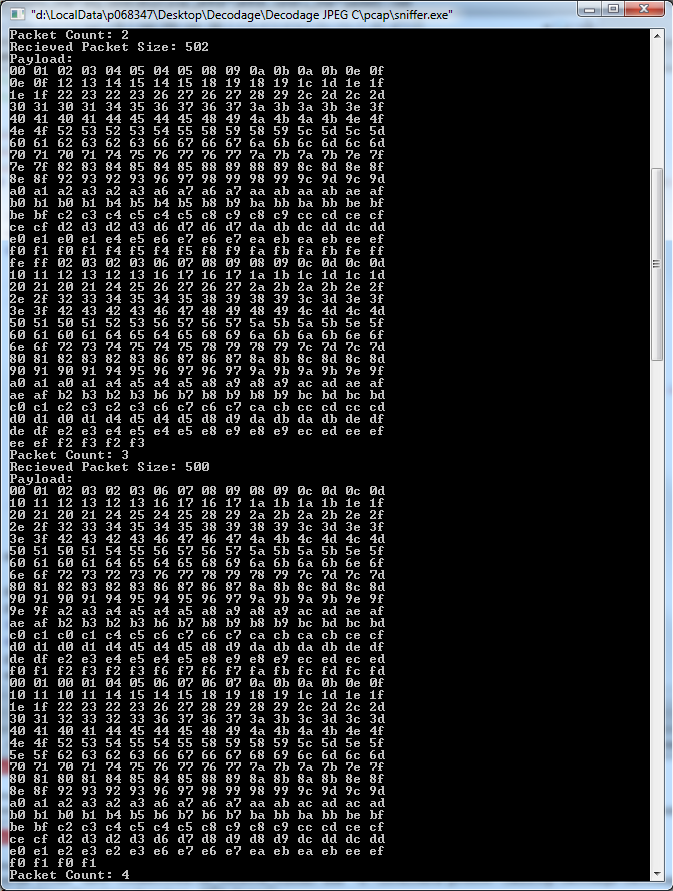

I've configured FEC in a MPC5604 to send frames to a PC. I sniffe PC ethernet port to verify that the data has been sent. It works, but the data received in PC is sometimes inverted or lost.
First, I configure I/Os, configure and start ethernet devices, configure the PHY with all reference manual recommandations, and it works perfectly. My TxBD buffer pointer is initialized with :
txDesc[0].length = 500;
for(i=0;i<500;i++)
       txBuf[i]=(unsigned char)i%256;
__flush_cache(txBuf,500);
After, I set the BD status and mark TDAR as ready to start :
txDesc[0].status = 0x8C00;
FEC.TDAR.B.X_DES_ACTIVE = 1;
When I sniffe PC ethernet port I have :
For example, in the first packet, it loses 06 and 07 and sends 0a and 0b two times. (and this error occurs many times)
I also verified memory addresses and they are perfect : 01,02,03 ..., FF
I don't know if its an ethernet DMA problem or any register configuration. Anyone did have this same problem?

I finally found the solution :
The system CLK didn't match with my MII configuration. I create a function to configure system CLK in RUN0 mode :

And in the FEC configuration, I set MII_SPEED=0xC. From MPC5604ERM page 874:

So, for SYS_CLK=60MHz :
FEC.MSCR.B.MII_SPEED=0xC;//set MDIO speed
Finally, it works perfectly.
Nothing is inverted and no data is getting "lost" in that there are no missing bytes in the data stream. It is repeating or duplicating 16-bit words.
How often does this happen? You've given two examples, both showing the problem. By "sometimes" do you mean "sometimes duplicates words" (about half the time from the above) or "sometimes sends packets like this"? Does it ever get it right?
This problem doesn't look like it is caused by the FEC. It looks more like a memory problem of some sort.
If you look "down the columns" of your screen captures (you could have done a cut/paste to get the raw text BTW) you'll see the first column always has "0" or "e" as the last digit and so on.
So it is always reading the expected 16-bit value or the PREVIOUS 16-bit value, and never any other data.
This is very hard to explain if you have 32-bit memory and the FEC is reading 32 bits at a time, as it would require some intermediate "byte-lane changing hardware" to be doing something stupid.
It would be easier to understand if you've got 16-bit RAM, or a 16-bit pathway between the FEC and the RAM. the "pathway" is unlikely as the FEC is a master on the Crossbar.
You've got 96k of SRAM in there. I thought you might be running from an external 16-bit RAM, but that chip doesn't seem to support that. So you have to have the rings and the buffers in the 96k Static RAM.
Are you obeying the buffer alignment requirements? If your buffer starts on an "Odd-1", "Odd-2" or "Odd-4" address instead of the required alignments. Ring pointers "must be 128-bit aligned." Also "The transmit buffer pointer contains the address of the associated data buffer, which is 16 byte aligned."
