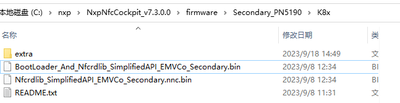

I tracked the sequence of program execution, and they all used the underlying SPI interface. I suspect that turning on RF has affected the normal activity of SPI. So, I burned the BootLoader firmware  and tested it by NFC Cockpit.
Before opening the RF, I had no problems reading and writing EEPROM.
Once I opened the RF and performed any reading and writing operations, it would display an error.
This confirms my hypothesis of RF and SPI. May I ask how I can solve this problem?
Additional note: I have tried secure firmware for 2.5, 2.6, and 2.7, but the issue cannot be resolved.

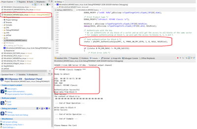

Do you have MIFARE Classic card which is designed by NXP? It's recommended you could use the NXP sample card to try again.
kelly
1,616 Views
pathbreaker
Hallo Kelly
Yes, I used MF1S70 and tried it again. As I mentioned above, for a period of time after resetting, it is possible to read and write to the card, but then there is a problem of stuck memory.
1,552 Views
KaiLi
Hello @pathbreaker
Yes, I've done the same test as you, but everything is working, see the below. So, your MIFARE Classic Card should have some problems, please check it.
