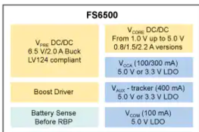

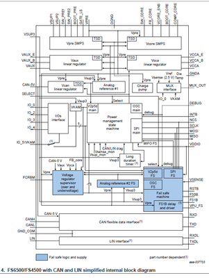

FS65
  1. In FS65 VPRE is internally connected to all other supplies. Will it reduce the supply current of PRE (which is 2A as mentioned) as FS65 internal circuit will also consume the current?

FS65:
1. This 2.0A includes both internal and external loads. Internal blocks like VCORE (DC-DC), VCCA (LDO), VAUX (LDO) and CAN_5V (LDO) are all powered from VPRE. If your application requires external current from VPRE, you must subtract the internal consumption from the 2.0A budget.
