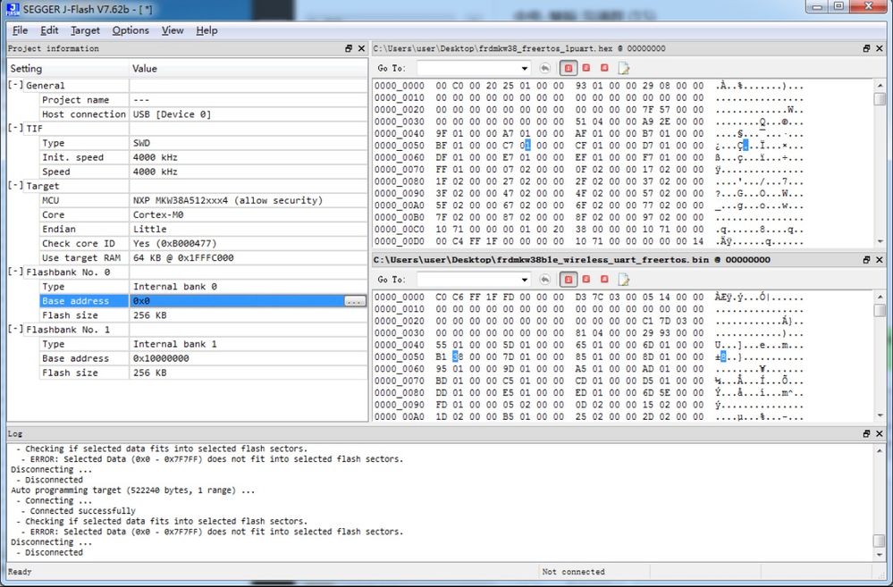

KW38 is 256kb program flash + 256kb flexnvm.
When use J-Flash erase show : selected data does not fit into selected flash sectors.
How should I slove it?

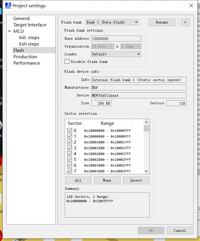

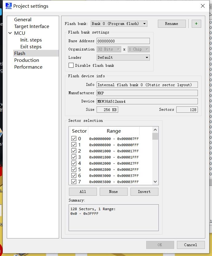

Are you trying to perform an Erase Sector or is it Erase Chip (Manual programming)? Does this error occur if you try to program a binary file?
By any chance, have you modified the Flash setting? Could you please share a screenshot of your Flash settings (Options tab > Project Settings… > Flash)?

jingfang
I test J-Flash V7.70 with demo board KW38,the problem points remain.(IDE GUI FLASH TOOL is OK).
J-Flash set as follows:
The bin file size is 520KB.

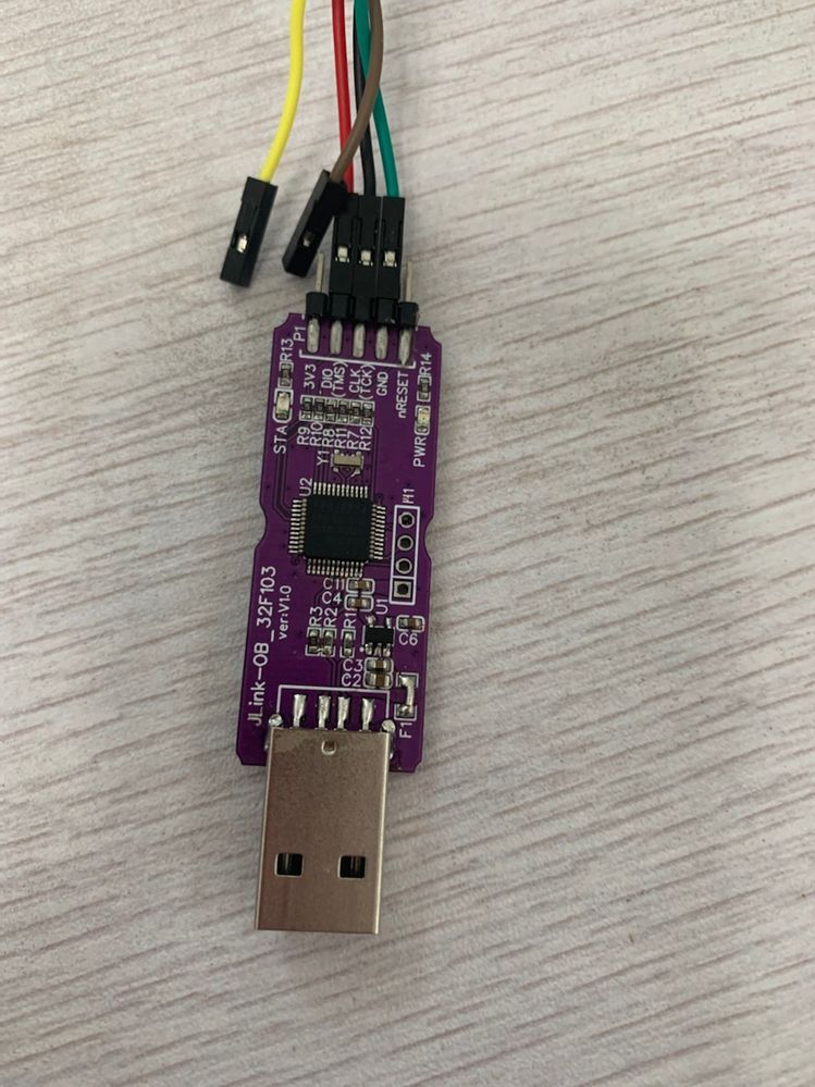

Just to confirm, what is the programmer/debug probe you are using (for example JLink base, JLink Pro, JLink Plus...)? I am still trying to reproduce this scenario on my side.

jingfang
small size bin is ok,I split the 512KB bin into 256+256KB,it is ok.
Jlink as follows:
