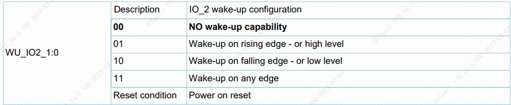

Customer want only rising edge , not want high level,
Whether there is a register that can set the rising edge to be valid?

By setting WU_IOx_1:0 bits to 0b01 it is only possible to select a wake-up on rising edge or high level.
