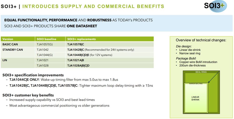

What is the difference between TJA1021T/20 and TJA1021BT?

Hi Tomasz,
The TJA1021BT is based on our latest SOI3+ process. Below you can see the changes and benefits of this process. The TJA1021BT  is a drop-in replacement for TJA1021T/20, meaning it is pin-to-pin and HW/SW compatible.
Tomas
