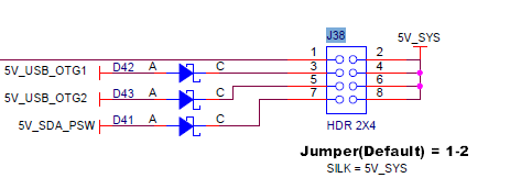

Hii,
When I am trying to debug the imported example of IMXRT1170-EVKB IN MCUXpresso-IDE, it is not going into the debug and getting an error. Only once it went into the debug correctly, after that it is throughing errors. And I also attaching a file of the debug issue shown in the IDE.
I've connected power cable to the J43 and USB (debug) to the J86 and SW5 is in ON Position.

Hi @Shivani_Elavena ,
First, I advice you check J38 setting. If you use power cable to the J43, J38 Pin1 should connect Pin2.

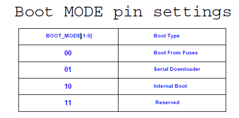

Second, Please check your BOOT_CFG and  BOOT_MODE configuration.
Normally, If you do not modify your MIMXRT1170-EVKB board, Please set SW2 all 0, Set SW1:0010(Internal Boot).
