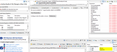

I'm getting 0x3 fault (interrupt program  status register) and getting hang in
FLEXSPI_Init(base, &config);

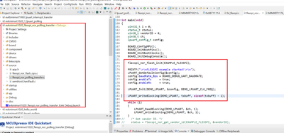

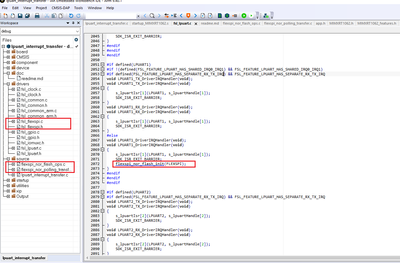

I tried to reproduce your question. I add FLEXSPI related files based on lpuart_interrupt_transfer example.
And i add flexspi_nor_flash_init(FLEXSPI) in the lpuart interrupt function. I did not add flexspi related pin initialization.
You can refer to the picture.
It can work without any mistakes.
So I think there may be some issues with your code, please double check it.
Hope this will help you.

I tested  your project on my board. I have encountered the same issue as you. And I ported the code in my own project. The same code works on IAR but not on MCUXpresso.  I will investigate this issue.
There are two workaround.
You can run your project using IAR IDE.
Or you can add lpuart polling code in flexspi_polling example on MCUXpresso.
 I have tested both methods and they can work.
And i will continue investigate the issue.
