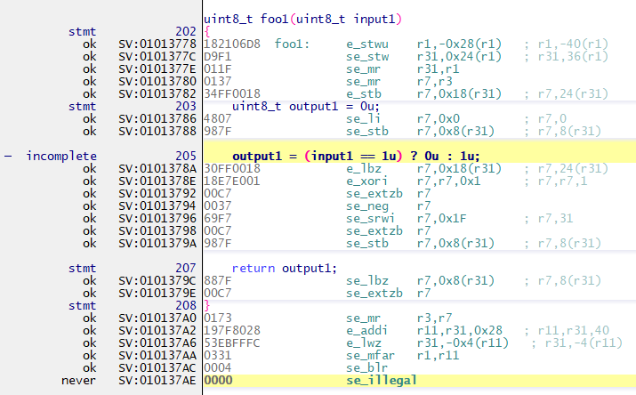

I am measure code coverage for some APIs relative ternary operator. Saw debugger cannot recognize branch when ternary operators are used and missing e_b also. It gives bad results measure code coverage. Please help me check it. My debugger as below:
  • Function not taken decision:
  • Function foo1 not taken decisionFunction foo1 not taken decisionFunction foo2 not taken decisionFunction foo2 not taken decisionFunction foo4 not taken decisionFunction foo4 not taken decisionFunction foo5 not taken decisionFunction foo5 not taken decisionFunction foo5 not taken decisionFunction foo5 not taken decision
  • Funtion taken decision:
        Funtion foo3 taken decisionFuntion foo3 taken decision

uint8_t foo1(uint8_t input1)
    uint8_t output1 = 0u;
    output1 = (input1 == 1u) ? 0u : 1u;
    return output1;

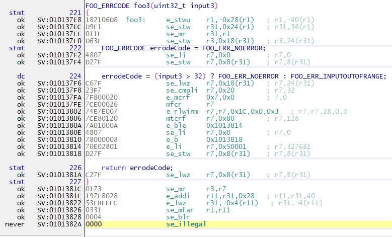

FOO_ERRCODE foo3(uint32_t input3)
    FOO_ERRCODE errodeCode = FOO_ERR_NOERROR;
    errodeCode = (input3 > 32) ? FOO_ERR_NOERROR : FOO_ERR_INPUTOUTOFRANGE;
    return errodeCode;

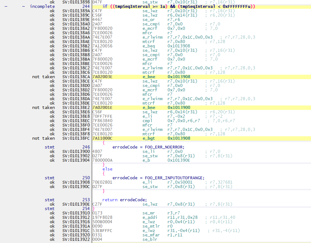

FOO_ERRCODE foo5(float32_t SeqInterval)
    uint64_t tmpSeqInterval;
    tmpSeqInterval = (uint64_t)lroundf(SeqInterval * 1000.0f / 25.0f);
    if ((tmpSeqInterval >= 1u) && (tmpSeqInterval < 0xFFFFFFFFu))
    else
        errodeCode = FOO_ERR_INPUTOUTOFRANGE;
    return errodeCode;

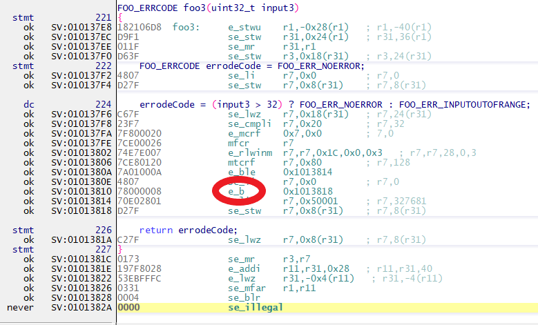

In my driver have a lot of ternary operator are used, I am trying cover all ternary operator, almost them are taken 100% coverage report by TRACE32. Some ternary operator cannot taken, I sure I have unit test for cover them, but TRACE32 reported improper. Actually, I don't know root cause issue yet.
I checked assembly code by debug TRACE32. Saw ternary operator are not taken 100% coverage have not command "e_b". Checked in ternary operator taken 100%, saw all of them have command "e_b".
I guess TRACE32 need command ""e_b" to measure code coverage.

what comes to my mind, is compiler translation.
Try to play with compiler optimizations, like no optimization at all , etc...
Debugger really displays only what is translated.
Also check output files form compilation to see if the translation corresponds with what you expect.
