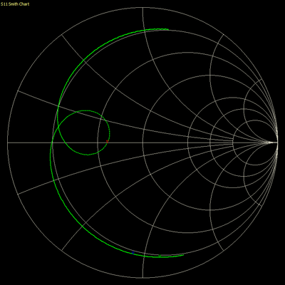

Currently i'm using PN7150 with android board.
The NFC reader (PN7150) can be used to read type A cards, but cannot detect type B cards at all.
Below is the PCB antenna that I use :
NFC AntennaNFC Antenna
Antenna dimensionAntenna dimension
The following is a schematic for the antenna matching circuit:
matching Circuit Schematicmatching Circuit Schematic
I got the antenna matching values from the calculation results from the Antenna Calculator.
Antenna CalculatorAntenna Calculator
I did the tuning process for the values C0, C1, and C2 and used the RFSim99 application. Below are the simulation results on the RFSim99 application:
RFSim99 schematicRFSim99 schematicSmith chart simulation results from RFSim99:
RFSim99 Smith ChartRFSim99 Smith Chart
Below is the signal shape (Smith chart) of the measurement results on the PCB board using Nano VNA.
Measure the signal using nano vnaMeasure the signal using nano vna
actual signal shape using nanovnaactual signal shape using nanovna
Please help me!!

The matching looks good. Need more information to check it.
