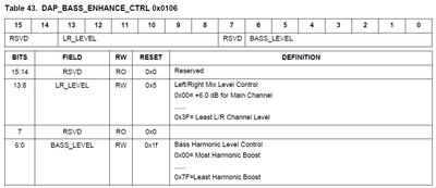

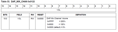

After download the datasheet of this component 'SGTL5000', I don't understand what is the maximum gain of this component.
For example
+6dB
+12dB
+6dB
+12dB
What does that mean exactely ?
Thank you for your helps

Hello Yann,
MIX gain:
For the detailed description of the AVC gain please refer to the page 23 in the datasheet.
When the measured audio level is below threshold, the AVC can apply a maximum gain of up to 12 dB. The maximum gain can be selected, either 0, 6, or 12 dB. When the maximum gain is set to 0 dB the AVC acts as a limiter. In this case the AVC only takes effect when the signal level is above the threshold.
Bass enhancement-please refer to page 21.
Tone control
With Best Regards,
Jozef

GSXR100038
Hello Jozef,
Thank you, but I can see theses values in my previous picture. I would like to know what is the maximum gain of this component ?
After this picture 40+22.5 =62.5 dB right ? This is the value maxi ?
I just need to know the max gain to design my electronic board.
