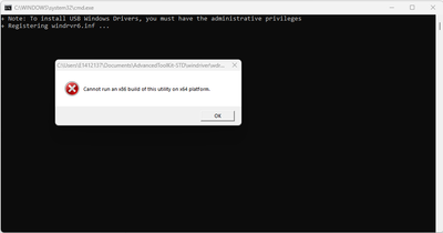

I use Advanced Toolkit (ATK) to perform flash on iMX35 chip on the PC Windows 11 64-bit operating system. I have run the batch file "wd_install_4NT" to install Windows USB drivers, then the program pops up an error message "Cannot run x86 version of utility on x64 platform".
Could you help find a driver that compatible with windows 11?

Hi @noom_electu , I stumbled across the same issue and afterwards I've found this GitHub - hbock/pyatk: Python implementation of Freescale Advanced Toolkit (ATK) serial/USB protocols... - Haven't tried it yet, but perhaps that could be a solution approach which could be investigated.

Hello @noom_electu
I hope you are doing very well.
Due to the lack of updates, ATK is not compatible with the latest Windows driver architecture and USB stack, and there are no updated drivers or patches available to make it work on Windows 11.
Apologies for any inconvenient.
