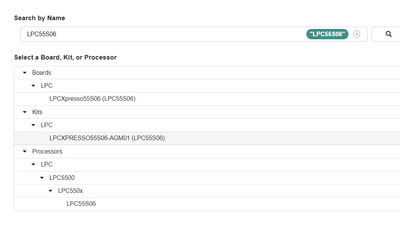

Hello caden013,
There is ADC demo under SDK, it support MCUXpresso, can directly open it.
Download from: https://mcuxpresso.nxp.com/en/select
Choose LPC55s06.
