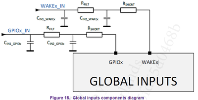

@Emmanuel.onyema, @john.floros, please review the attached final schematic and layout of FS26.

In regard to the FS26 device, your schematic seems correct. I just want to add some comments:
- The following circuit is recommended for the WAKE and GPIO pins:
- Are you adding the pull-up resistor on the INTB pin?
I do recommend using the schematic attached as a reference.

Perumal
Hi David,
Thank you. I'm good and hope you too doing good.
Please refer the attached review comments from NXP what we did early and conform your comments.
In that, Internal pull is suggested for INTB and no comments for Wake and GPIO.

Hello Perumal,
Once again, thank you for using the NXP communities.
Great. Please let us know if you have any questions in the future.
