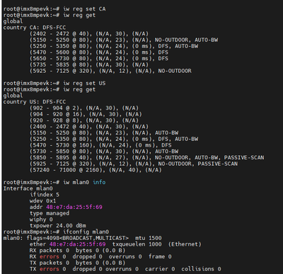

shaun_wu
Hello @johnj_dejero
I tried your problem on our platform, there are no problem. I think you may need to check host side setup.
Best Regards
Shaun
