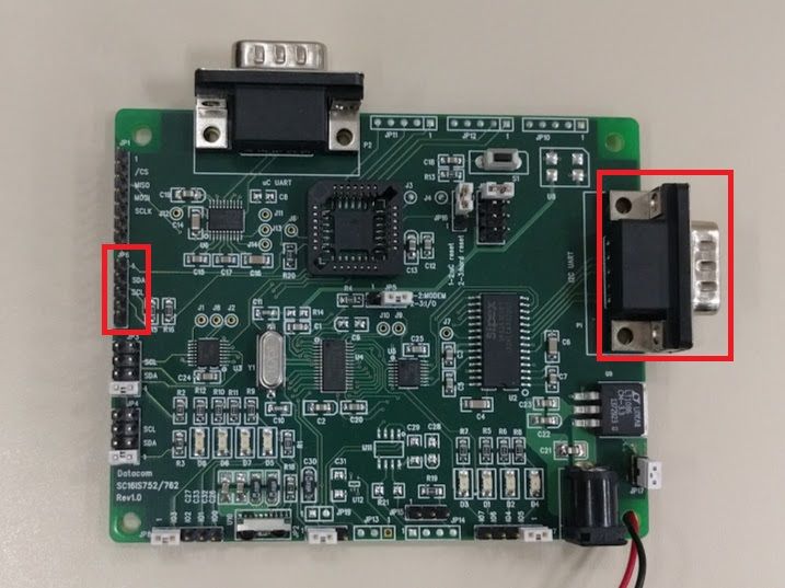

I would like to share with you a simple bare metal example for the the SC16IS752 to demonstrate NXP Bridge IC for SPI/ I2C host to Dual Uart/IrDa/GPIO interface. This example is based on the OM6273 demo board for the SC16752/762. I made this example working with the NXP FRDM-KL25Z development platform. The example shows the device functionality by creating a simple echo transmission, where you are able to read what you just write into the device.

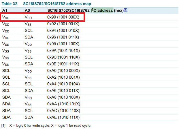

Before any data is transmitted or received, the master must send the address of the receiver via the SDA line. The first byte after the START condition carries the address of the slave device and the read/write bit. Table 32. shows how the SC16IS752/SC16IS762’s address can be selected by using A1 and A0 pins. In the demo board OM6273, these  2 pins are connected to JP4 and JP3 and in this example there are two jumpers plugged so A1 = VDD and A2 = VDD, then the SC16IS752’s address is set to 0x90(Write) and 0x91(Read), and the master communicates with it through this address.

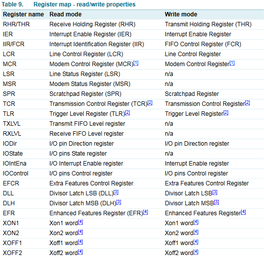

The second parameter in the read or write function is the internal register address, these are defined in the SC16IS752.h attached to this document and explained with greater detail in the SC16IS752 datasheet.
3. The SC16IS752 is set to work at 115, 200 baud/s , the Receive Holding Register interrupt is enabled and routed to the INT1 pin that is configured to be a push-pull, active-low output. The registers are shift 3 positions left because the UART's internal register select are the bits 3:0, as shown in table 33. In the example channel 0 is used.

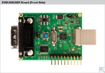

5. We connect the I2C lines with each other in the board, JP6 contains INT1, SDA and SCL in that order, then P1 is connected to EVBUSB2SER (USB to serial device), and this last one to a computer. In the computer must be installed a serial terminal,   for this example Teraterm is used

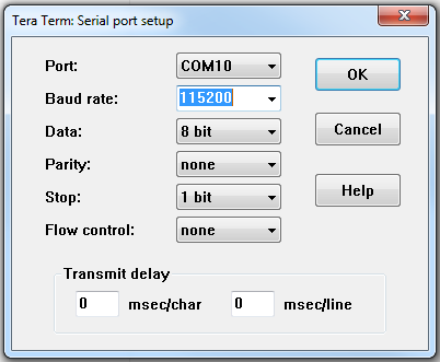

We set up Tera Term going to Setup > Serial Port and then select corresponding port to the EVBUSB2SER and baud rate 115,200
