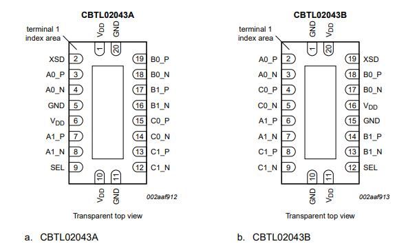

Q1. What is the difference between A and B?
CBTL02043A has input and output pins on the opposite of the package, and is suitable for edge
connector(s) with different signal sources on the motherboard.
CBTL02043B has outputs on both sides of the package, and the device can be placed between two connectors to multiplex differential signals from a controller.

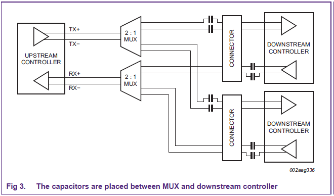

Q5. How to bias the high-speed switch?
PCIe, DP, USB3, and SATA electrical signals require AC coupling between the transmitter and receiver. The AC coupling capacitors are usually placed close to the transmitter.
CBTL02043 requires a bias voltage, less than 2 V, applied to its switches.
There are several AC coupling capacitor placement options:
A. The capacitors can be placed between the MUX and the downstream controller, and the MUX is biased by the upstream controller.

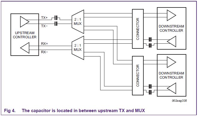

B. The capacitors can be placed between the upstream transmitter and the MUX.
RX signals on the motherboard sides usually do not require AC coupling capacitors since those capacitors are located on the add-in card. The TX MUX is biased by the downstream controller, and the RX MUX is biased by the upstream controller.

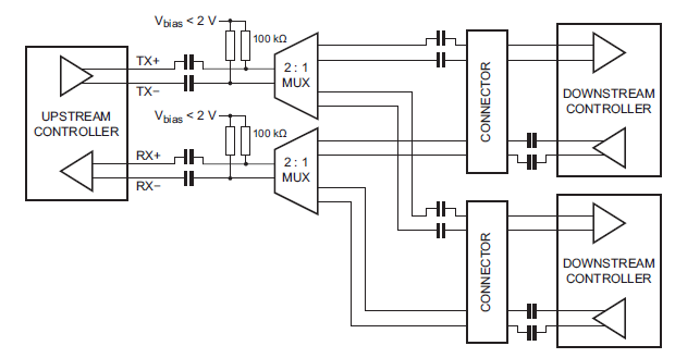

C. Do not place capacitors at both side of MUX, unless a bias voltage is provided.
In case of that both upstream and downstream controllers’ common-mode voltage is higher than 2 V, a bias voltage, which is less than 2 V, is needed for CBTL02043. The following figure shows an implementation in this case.
