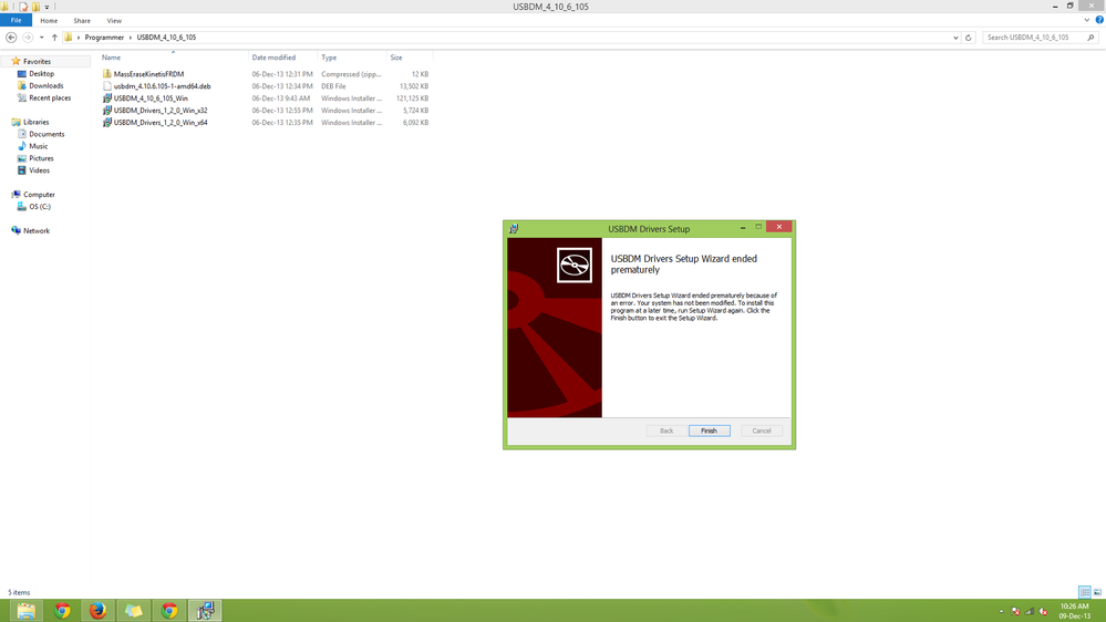

Hello
I am using windows 8.0,     64bit. I wanted to use my FRDM board as a programmer for programming custom designed board containing kinetis uc i.e K10. but when I am installing USBDM drivers on windows 8. the installation is being cancelled by the following error msg. I have checked the same with my friend's PC i.e on windows 7 everything is working fine as the driver is being installed in the PC there. I also searched a lot but didn't got any solution. I am using the latest version of USBDM i.e 4.10.6.105 from  USBDM - Browse Files at SourceForge.net kindly look into the matter.

I had the same problem. This is what I did:
Get a computer running Windows XP 32b or run it in a VM. I used VirtualBox in my Win8 host machine
Install USBDM software:
1) http://sourceforge.net/projects/usbdm/files/Version%204.10.6/Software/USBDM_4_10_6_120b_Win.msi/down...
and the driver for your WinXP machine
2) http://sourceforge.net/projects/usbdm/files/Version%204.10.6/Software/USBDM_Drivers_1_2_0_WinXP_x32....
Connect the USBDM and install drivers automatically, depending on the FW version of your USBDM it will tell you "bdm firmware version is incompatible" when trying to connect. If this is the case, run "USBDM Firmware Updater" which was installed with 1). Device will be updated.
After you have successfully update your firmware in WinXP. You can now switch to your Win8 machine. Download Zadig and install it in your Win8 machine:
Zadig - USB driver installation made easy
Open notepad, paste the following lines and save it as "USBDM.cfg"
--start //dont copy this line
[device]
  Description = "USBDM"
  VID = 0x16D0
  PID = 0x0567
GUID = "{93FEBD51-6000-4E7E-A20E-A80FC78C7EA1}"
--end
Connect the USBDM, open Zadig, load the USBDM.cfg file, select WinUSB and install the driver. This should install the signed driver and let you work under Win8
Regards!

Hi Amit
I had the same problem of you and I made a partition on my hard Drive Disc and I installed Windows 7
than I installed USBDM Drivers and everything woks well that was my solution to work with the USBDM mode
with my KL25Z.
good luck with your projects.

Hi Amit,
I have not tested USBDM with windows 8 so I can't make any guarantees.  I do not have access to a win-8 machine!
You can try installing the required driver using the Zadig software at :
http://zadig.akeo.ie/
Let me know how it goes.
bye

Hi Zhang
Thanks for your reply. Presently I am using USBDM and the link you have provided is for OSBDM. I think the drivers are not compatible with one another. It didn't work.
