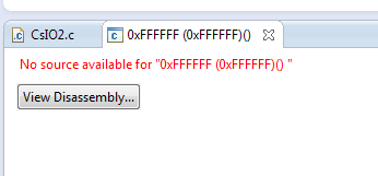

Hello
In CW10.6, I can't debug the S12ZVMC12EVB if I change the Internal bus clock at 30MHz or 50MHz in the CPU software component. I use the following connection : "USB1:Embedded S12Z OSBDM/OSJTAG Device". But if I keep the internal bus clock as default at 6.25MHz, I can debug the application.
Probably, I think the frequency of the "Embedded S12Z OSBDM/OSJTAG device" is limited.
Could you cofirm if I'm in right way ?
What is the maximum frequency of using the "Embedded S12Z OSBDM/OSJTAG device " ?
And when i configure the "Internal bus clock" to ""26MHZ" , it can work well .
while more than it , it can not debug, when debug ,it show like this :
Thank !

Hi fan,
An alternative to buying another programmer you could try changing to USBDM.  There is a firmware version that works with the OSBDM hardware similar to that on the board you are using.
I have upgraded the firmware on a smaller S12ZVML-MINIBRD to USBDM and it was able to operate with a bus frequency of 50MHz using Processor Expert.
The only gotcha is that you need a HCS08 programmer to change the firmware on the board :smileyhappy:.
You could also use an external USBDM - they are somewhat cheaper that the commercial alternatives.

I recieved feedback from P&E.
See below:
OSBDM interface supports run control debug with devices operating at bus frequencies between 500khz and 24Mhz.
Hence, it will not be able to support talking to a device operating at 30Mhz bus frequency.
For debugging device operating at higher bus frequency rates, we recommend looking into using P&E's USB Universal Multilink hardware interface:
          http://www.pemicro.com/products/product_viewDetails.cfm?product_id=15320137&menu_id=details
