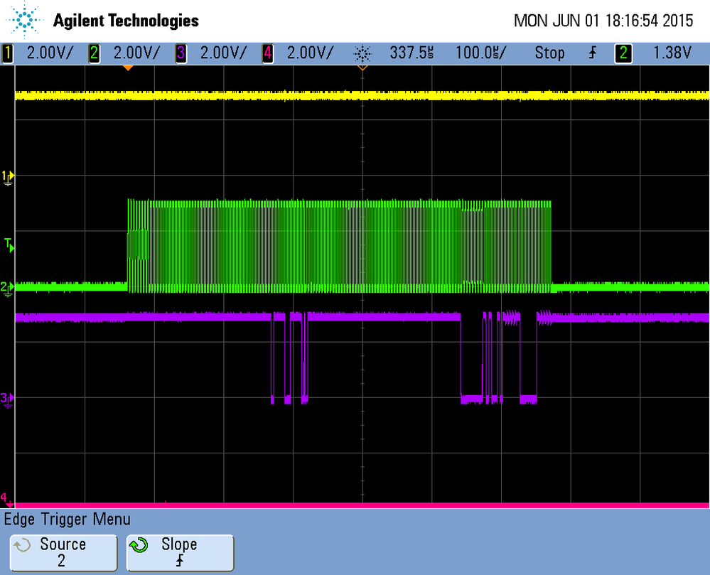

I double checked the SWD connection between the boards. I see the reset pulse on the oscilloscope, but still nothing.

I would expect activity on RST, SWCLK and SWD when connecting.
I had no problems programming the image you provided - but this was using a FRDM-KL26 board and the on-board interface.
There could be some issue with an external cable that I am not aware of.

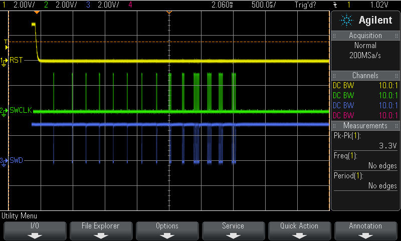

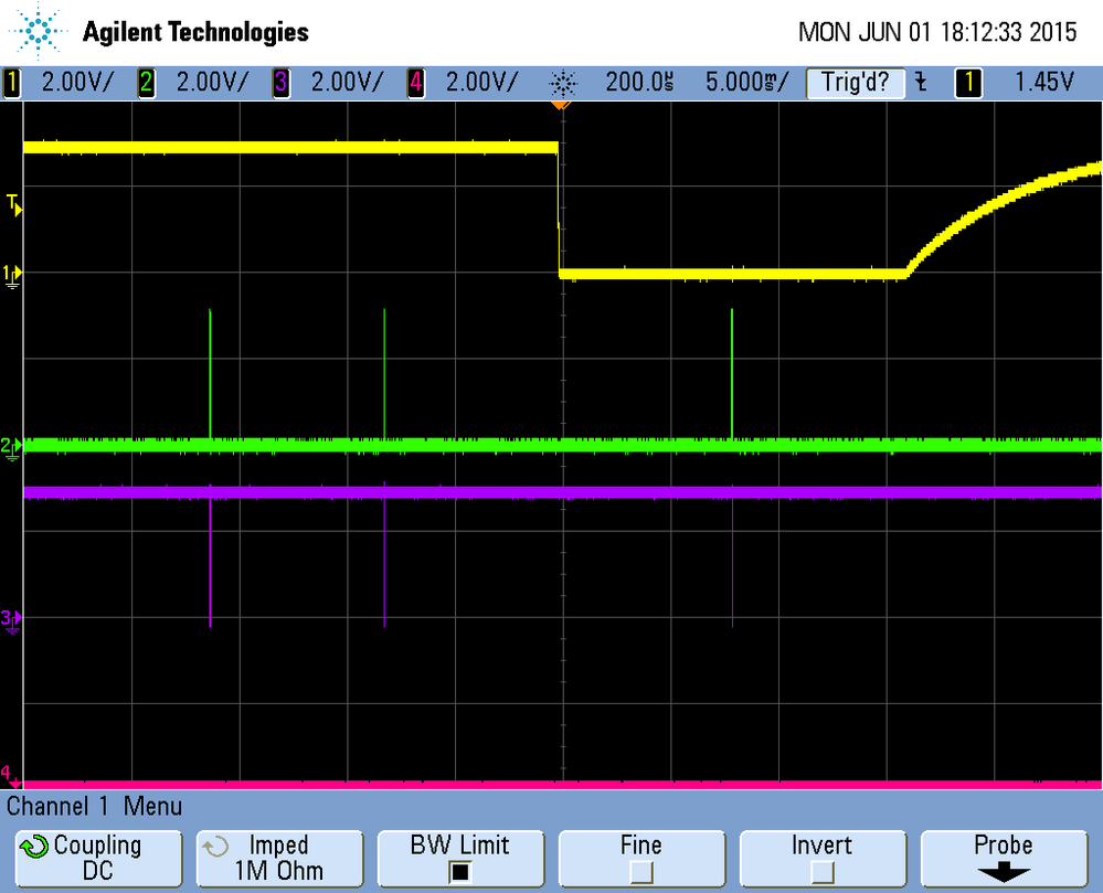

This is the last part of the waveform triggered on falling edge of reset when doing an auto-detect.
This is a close up of part of the waveform - the rounding is BW limited 10MHz on the DSO

When I try to "detect chip" using ARM Flash Programmer, I see the reset pulse and immediately get the "can't connect" error. SWD and SWCLK are high and show no activity. I checked continuity between connections and it seems OK. Any other things I may look for?

I can't think of a reason for having activity only on the reset line.

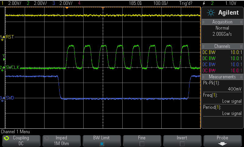

Could you try without any target connected - You should see something like:
(Results depend on the oscilloscope - the activity on SWD & SWCLK line will be more visible if the communication speed is set to 250kHz.)
The initial pulse is switching the interface to SWD mode from JTAG.  Close up it should look like:
If you don't see this I would seriously suspect the cable.

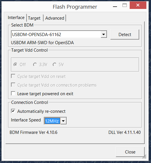

  • Try a USB2 port
  • Try high and low communication speeds
  • Try manually selecting target device and use Mass Erase Now to erase the device.

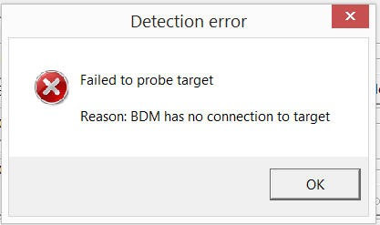

  • Use Detect Chip and please provide a screen grab of the actual error pop-up you get.  I would expect :
