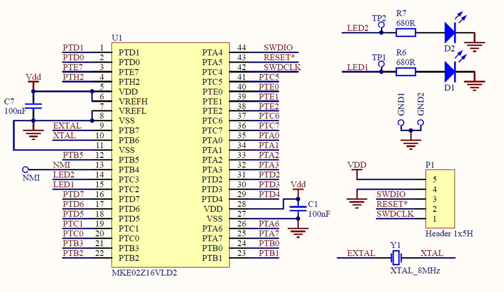

Senior Contributor V
Hi Raimond,
Can you provide the exact part number of the device you find the programming fails on?
The circuit might also be useful.
thanks

Hi pgo,
what failed was an MKE02Z16VLD2 and an MKE02Z64VLD2 (16K and 64K otherwise
the same chip).
One of them has NMI as output, but it's driving a load that has a 13K
equivalent resistance to GND. The other one is an input (the MISO pin at a
SPI port). That one receives the output of a SPI device.
I also disable the NMI in my firmwares. This NMI thing is annoying, I don't
know why this NMI thing gets in the 21st century microcontrollers...
Hi Raimond,
I suspect it is the NMI that is upsetting the programming.
I have ordered a MKE02Z16VLD2 and will build a minimal prototype for testing but this will not occur for a while.
The NMI can't (normally) be disabled in by the USBDM programming since once disabled it cannot be enabled except by a power-on reset I believe,
bye

Sorry to hear that! Thanks for your patience.
I will probably upload V4.12.1.170 anyway, as it has some other bug fixes.
The device tested was a MKE02Z64VLD2 with the following very minimal circuit:
The test file was a random data image 64K flash+256 byes eeprom.
Testing was done with a MK22F and a JS16-SWD version of USBDM hardware.
Tested with NMI open and pulled low.
This testing was done with the stand-alone programmer.
Can you upload you test program please and I will see if it behaves differently.
It is also possible that some other changes in V4.12.1.170 affect things I suppose.
bye

Connect the leds in sinking mode like this (I noticed you put your leds in
sourcing mode):
2017-04-14 8:39 GMT+03:00 Raimond Dragomir <raimond.dragomir@gmail.com>:
Hi pgo
Here it is the cpu. It doesn't use an external crystal. Just after reset
it toggles the LED1...LED4 in sequence, 50ms per led.
I've also attached the elf file, so you can load it.
here it is the startup:

Hope this help. If you connect at your board the leds on the pins used in
my schematic, you should see them light only once after reset for a good
program. As I said, when programmed with the current 160 with the patched
script, I can see them light repeatdly, the sign that there is a reset at
some point.

The image file appears to contain data intended for RAM.  The programmer  is choking on that:
    doFlashBlock(): op=OpWriteRam, [0x1FFFFC00..0x1FFFFC2F]
    doFlashBlock(): Processing RAM[0x1FFFFC00..0x1FFFFC2F]
       loadTargetProgram(): Failed, no flash program found for target
It is unusual to have RAM in an image intended for programming but the programmer should still write the data to RAM -  It appears to be confused and is looking for a programming algorithm that applies to that range of memory.
RAM processing is done as a second pass after the Flash programming.  This means that the Flash has actually been successfully programmed.
I'll look at the reason for the failure.  It may be that the ELF loading code is incorrectly assuming the RAM block needs to be loaded.
I would also suggest you check your map file and linker file to see where the RAM data is coming from.  The segment may be incorrectly configured.
Either way it should not fail in this fashion.
bye
PS.
OK - fixed (I hope) in the version being uploaded.
As a further note: Images containing RAM data may fail verify as the RAM data is (of course) volatile.
289 Views
Weird. See the files attached. From what I can see the ram implied is from
the .data segment, the load address being 0x03C90 in flash.
I may suspect that your program loaded the flash only until the 0x03C90 and
the last 0x30 bytes directly in RAM... And my application just doesn't have
the data at 0x03C90 at runtime...
Hi Raimond,
Version 4.12.1.170 uses a different method for loading ELF files which should operate correctly,
bye
286 Views
It's working, thanks!
