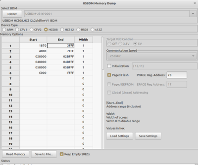

Hi there,

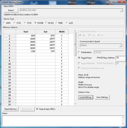

I'm trying to make a dump of the full flash memory of the MC9S08AC96 chip,
which has a 96K FLASH memory.
But I'm a bit confused by the memory map in the specifications (see attached picture).
I found that in the specifications it is stated PPAGE = 78, so I have to set it to 'paged memory' when reading. Then I can succesfully read PPAGE=0, PPAGE=1, PPAGE=2, PPAGE=3, see attached picture.
But I'm still not at 96K... Still missing is PPAGE=4 and PPAGE=5.
Where are they hiding? If I set the address to 10000 - 13FFF and 14000 - 17FFF I get an error.
Does anyone know how I can dump the full 96K flash?
Thanks!

The failure for the verify of MC9S08AC96_AllPages_byAno is really a bug in the programmer.  It is confused by the security area being in the main memory map and also appearing in a memory page.  I believe it will verify if you select Unsecure option.
An improved memory map is attached MC9S08AC96_ModifiedMap.cfg.  This is paged apart from PAGE3 (which contains security information) which is directly accessed.  This captures all the Flash without any security issues.  I suggest you use this configuration to backup the chip and verify using the programmer.
The good news is that the PAGE0 does contain information that is not visible in the reset memory map.  This page (or at least the lower portion) must be used in the paged area.  This may account for the failure.

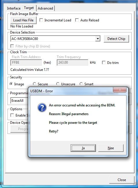

Updating the software from 4.12.1.262 to the latest version 4.12.1.330 did not go so well...
The USBDM Memory Dump tool works fine (as before), but when I run the HCS08 Programmer tool now, I get an error... (see attached screenshot).
Maybe my mistake was that I installed the new version alongside the old version (without uninstalling the old version first)?
I now uninstalled both versions, uninstalled the drivers, rebooted, installed the drivers, install the new version again, rebooted. But I still can't run the programmer, I still get this error
Anybody knows how to fix this? I hope so.
20,049 Views
Ano
I found out why I got this connection error.
After upgrading the program, for some reason all time settings were set to "0 ms". After restoring the 'normal values' the program works well again:

Today I did some testing.
The machine I'm working on has two pcb's, a 'power pcb' and a 'control unit pcb'. Both pcb's contain this MC9S08AC96 chip.
I started making a dump of the power pcb chip using the "Memory dump" tool, with the settings as described by @pgo (I attached a screen dump of my - updated - program), followed by a verification of the dump using the "Programmer" tool. The pcb has a connector to access the chip. That went well.
(The updated program is quite convenient, as you now can save and load settings )
Then I desoldered the original chip from the power pcb and soldered an a brand new MC9S08AC96 that I bought at mouser.com. I flashed the new chip with the dump using the "Programmer" tool, followed by a verification. That also went well.
