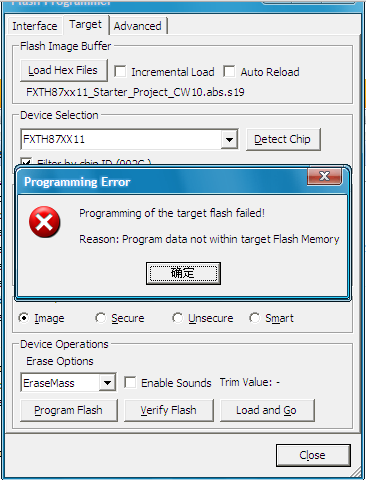

Now,when I try loading my .s19  file to the FXTH8709116T1, I got this
But when I create an new empty project, the .s19 file can be load by HCS08 programmer successfully.
When I use codewarrior 10.5, it can flash my target file successfully, but the target device seem not run successfully, I am very confused

Hi Xia,
I suspect you have erased the top sectors of the device somewhere along the way.  This will result in a secured device.
When you try to read from a secured device you get all zeros.
If this is the case you have little choice but to do a mass erase and reprogram one of the file images provided on the previous link provided (above).
bye

Dear Xia,
When you created your project in Codewarrior did you change the memory map to avoid re-programming the semi-permanent information in the upper region of the chip? See the previous discussion thread.
Can you post the image file you are programming please?
bye

xiaalina
When I try to debug using USBDM, I got this
the attach file FXTH87xx11_Starter_Project_CW10.abs.s19 can not be programmed by HCS08 progarm;
the attach file 20151201.abs.s19 can be programmed by HCS08 progarm, but the progarm can not run.

pgo
Senior Contributor V
Hi Xia,
The example files you provided appear to cover the correct memory ranges so I am unsure what is causing your problem.
It is possible that the upper ROM has been erased.
I suggest you program the chip with the file that programs OK and then use the memory dump program to read-back the entire memory image to check that upper region of the Flash has not been erased somewhere along the line.
Refer to this page for some more information:
USBDM: Programming devices while preserving data

xiaalina
the attached file is the image file.It seems all 0. Is there any problem?

pgo
Hi Xia,

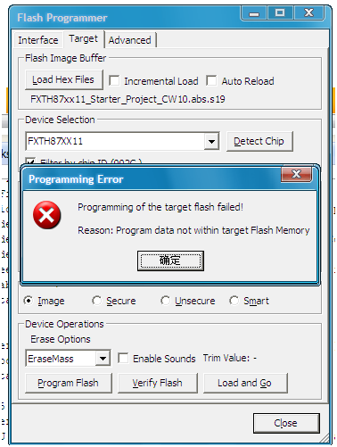

xiaalina
     pgo,
           I load the image file  FXTH870911_Image.sx  already.
           When I  loaded my .s19 file, I set in codewarrior about " EraseSelective" already  and build my project, creat .s19 file.
           I select EraseSelective on the stand-alone HCS08 Programmer,but I got this,Why?

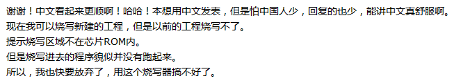

xiaalina
谢谢!中文看起来更顺啊!哈哈!本想用中文发表,但是怕中国人少,回复的也少,能讲中文真舒服啊。
现在我可以烧写新建的工程,但是以前的工程烧写不了。
提示烧写区域不在芯片ROM内。
但是烧写进去的程序貌似并没有跑起来。
所以,我也快要放弃了,用这个烧写器搞不好了。

xiaalina
Dear pgo,
          I restart my computer, the target can be connected finally,.
         The flash programmer  can load an empty project,but it can not load my own project. i got this:
Do I need these files:
  • Image from a FXTH870911, FXTH870911_Image.sx
  • Updated device file hcs08_devices.xml  This adds three devices FXTH870000, FXTH87xx11-Full-Erase and FXTH87xx11
    • FXTH870000    I do not have the code.
    • FXTH87xx11-Full-Erase    I do not have the code.
    • FXTH87xx11   Now I add it to the file hcs08_devices.xml
how can I get the files above?
