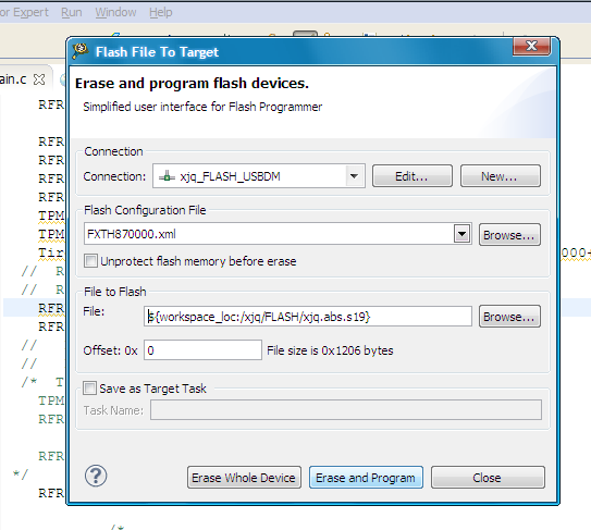

Hi,pgo
1    my chip number is  FXTH8709116T1
2    my debug and program tool is USBDM
3    my  development tool is codewarrior 10.5

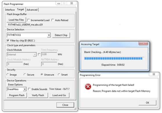

Now,when I try loading my .s19  file to the FXTH8709116T1, I got this
But when I create an new empty project, the .s19 file can be load by HCS08 programmer successfully.
When I use codewarrior 10.5, it can flash my target file successfully, but the target device seem not run successfully, I am very confused

Hi Xia,
I suspect you have erased the top sectors of the device somewhere along the way.  This will result in a secured device.
When you try to read from a secured device you get all zeros.
If this is the case you have little choice but to do a mass erase and reprogram one of the file images provided on the previous link provided (above).

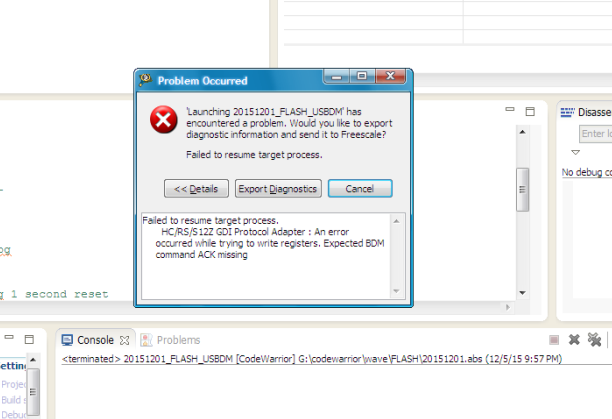

xiaalina
When I try to debug using USBDM, I got this
the attach file FXTH87xx11_Starter_Project_CW10.abs.s19 can not be programmed by HCS08 progarm;
the attach file 20151201.abs.s19 can be programmed by HCS08 progarm, but the progarm can not run.

pgo
Senior Contributor V
Hi Xia,
The example files you provided appear to cover the correct memory ranges so I am unsure what is causing your problem.
It is possible that the upper ROM has been erased.
I suggest you program the chip with the file that programs OK and then use the memory dump program to read-back the entire memory image to check that upper region of the Flash has not been erased somewhere along the line.
Refer to this page for some more information:
USBDM: Programming devices while preserving data

xiaalina
hi
  pgo, I  do a mass erase and reprogram fxth870511_Image.sx, then load the .s19 file in the codewarrior 10.5 ,the chip can run sucessfully.
5,672件の閲覧回数
xiaalina
I download my file using the codewarrior 10.5 flash devices. but I can not download using hcs08 program. I am very happy, my chip can run successfully, thank you very munch!

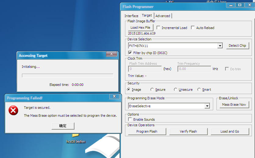

xiaalina
     pgo,
           I load the image file  FXTH870911_Image.sx  already.
           When I  loaded my .s19 file, I set in codewarrior about " EraseSelective" already  and build my project, creat .s19 file.
           I select EraseSelective on the stand-alone HCS08 Programmer,but I got this,Why?

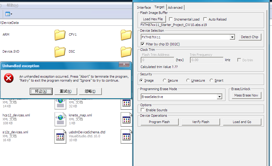

xiaalina
Dear pgo,
          I restart my computer, the target can be connected finally,.
         The flash programmer  can load an empty project,but it can not load my own project. i got this:
Do I need these files:
  • Image from a FXTH870911, FXTH870911_Image.sx
  • Updated device file hcs08_devices.xml  This adds three devices FXTH870000, FXTH87xx11-Full-Erase and FXTH87xx11
    • FXTH870000    I do not have the code.
    • FXTH87xx11-Full-Erase    I do not have the code.
    • FXTH87xx11   Now I add it to the file hcs08_devices.xml
how can I get the files above?

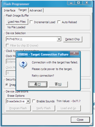

xiaalina
Dear pgo,
        1Where can I get the image file?
        2 Do you mean this kind of file?   Such as your FXTH870511_Image.sx
        3I don’t change the memory map when I creat project in codewarrior.
       Now I met an new program, I can not connect the target in any case, I check the hardware , it is no problem, I try two target, the problem is same. Now, I need to solve it firstly.
