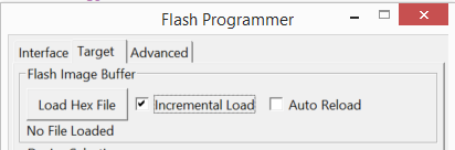

Hi Sunrme,
To change the security it is necessary to erase the sector containing the security data,  Since some of this sector is needed for the pre-programmed firmware it is not possible to change the security without damaging the firmware.
The process you have followed would avoid the above problem and appears workable.
I can't offer an alternative if a checksum is used.
I'm unsure what the process is for other programmers but I cannot see how they could avoid the problem.
I cannot find any reference to security in the firmware manual and the chip manual blithely suggests changing the NVOPT byte but this leads to the problem you have outlined.
If the firmware doesn't use a checksum then the following process (should) work.  It is basically a slightly easier method of obtaining what you have already done.
  1. Use the memory dump program to obtain a copy of the firmware from the chip you are actually programming. This is necessary because as well as the firmware there is individual calibration data programmed to each chip.
  2. Load this into the HCS08 programmer.
  3. Select incremental load.
  5. Load your program (including the security information)
  6. Select the full-erase version of the chip option and mass erase.
  9. Select image for security
  11. Program the target.
This should combine the existing firmware with your program.
Alternatively, select Secure and don't have security information in your image.
If you try this please let me know if it works.
I suggest you post a question on the general HCS08 forum to find out what the 'recommended' approach is in general i.e. not specific to USBDM.  There may be some process we are unaware of.

sunrme
Hi pgo!
Big THANK YOU for your so fast reply. Your method work excellent and it much more easier then my. I will post in sensor forum about this issue.
