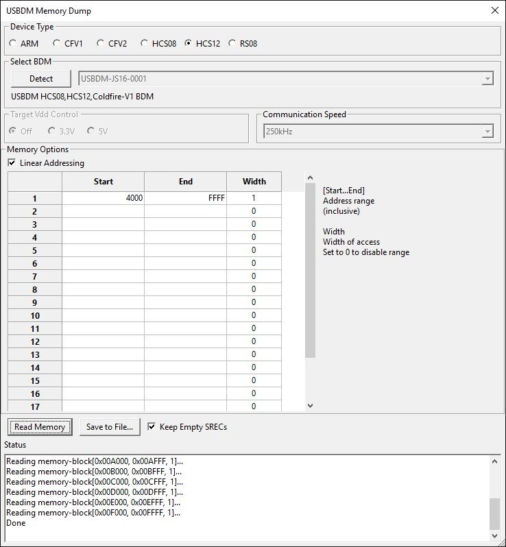

My task is to upgrade a 9S12D64 with a newer version of software (no matter about what). My first idea was to read the unit (to have a backup), and I did it without problems with the memory dump utility, reading from 0x0000 to 0xFFFF (in reality I read from 0x4000 as the first part is RAM area). It generates a good loking S19 file, but I looking inside the file, it's strange to find that the adress from 0x4000 up to 0x5000 was empty (0xFF)... it sound like a mistake in the read procedure from my side.. perhaps i did something wrong... can someone tell me if I get a correct (and complete) dump?

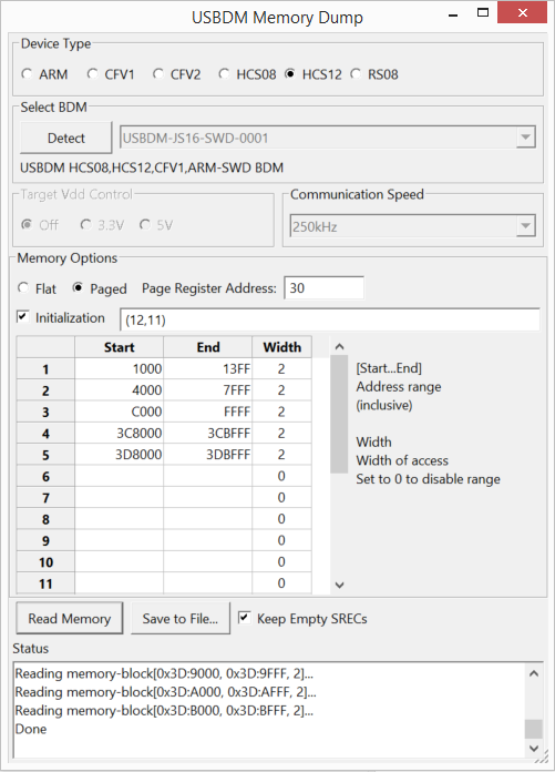

The simple answer is that the Memory dump program doesn't support paged addresses.
I have rectified this in the current version just uploaded.
I have confirmed operation with a MC9S12A64 chip which is similar to the one you are using.
  • It was tested it with a memory image that filled the entire memory (Flash+eeprom) with random data.
  • This image was programmed to the target using the MC9S12A64ALT device which locates the EEPROM@0x1000.
  • The following settings were used to read the data back using the current version of USBDM_MemoryDump
  • The saved image was the same as the original apart from S0/S9 records.

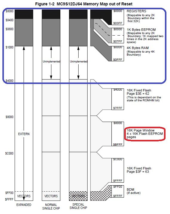

According to the memory map in the manual (p27) the D64 supports paging with 64K flash with the last page being 0x3F so I think the original entry was correct.

Looking at the memory map of the uC, the region paged is just between 0x8000 and 0xBFFF, that in this particular case, have 4 pages. The first 0x0000 to 0x4000 are irrelevant.. right?

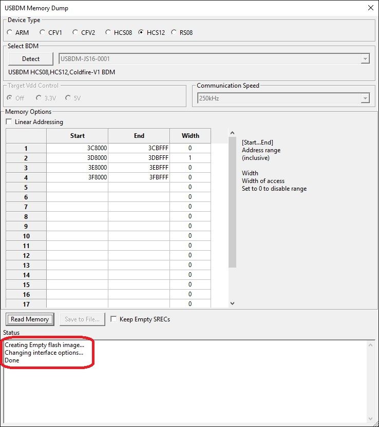

  • When the first section is disabled using 0 as width, nothing is readed. This is a capture of the tool after press "Read Memory"

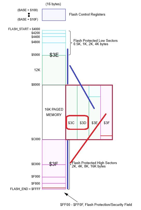

  • Acording with the physical memory organization, there are 4 pages (in this case of 64kB). Two of this pages are directly linked to a fixed memory address, and the first to pages can be selected by a register, to be shown in the range 8000-BFFF. Take a look:
This means that:
      • Range from 0x4000-0x7FFF: is liked with 0x3E8000-0x3EBFFF
      • Range from 0x8000-0xBFFF: can be linked with 0x3C8000-0x3CBFFF OR with 0x3D8000-0x3DBFFF
      • Range from 0xC000-0xFFFF: is linked with 0x3F8000-0x3FBFFF
If I try to read those four segments with the dump tool, I just get the same segment (the first one, so starting with 0x3C8000) copied 4 times.
