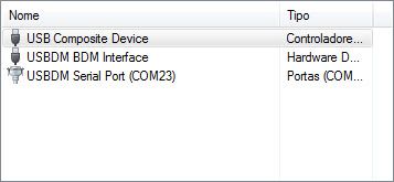

arturlazarini
Hi pgo
thank you for your response.
I installed the software and drivers again just to be sure.
For the frdm-KL25 the windows says that the device is a unknown device (by the way I'm using windows 7 ultimate).
For the frdm-KL64 the drivers are okay and "working". Windows can find it but USBDM software can't.
If I click in "detect" the BDM firmware Ver 10.45.214 changes to BDM firmware Ver 69.66.40 and thats all.
The device is always as busy or not responding.
Any ideias about this issues?
Thank you again for your support.

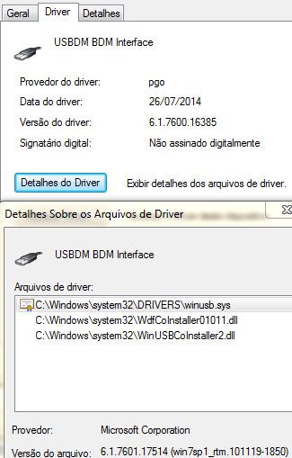

Could you do the following please:
  • Could you open the device properties in device manager by right-clicking on the item.
  • Select the Driver Details in the Driver Tab
  • Could you post the details available.  They should be similar to:
In addition could you try running the debug version of the ARM programmer:

arturlazarini
Hi pgo,
The drivers look the same for me.
I run "ARM_FlashProgrammer-debug.exe" and as you said it didn't work. So I run "ARM_GDBServer-debug.exe" and created the logs.

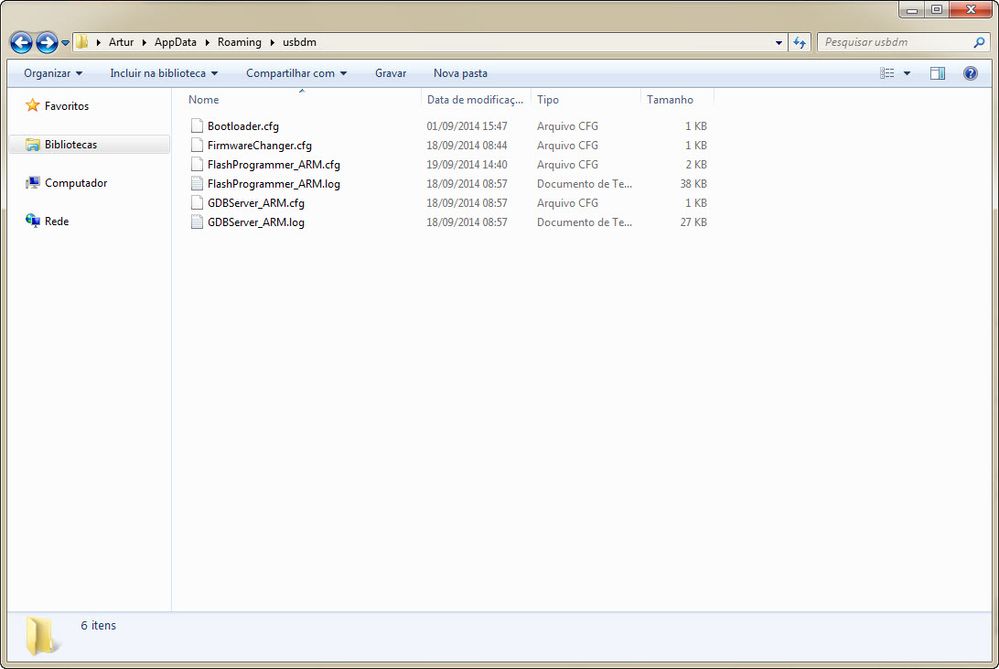

arturlazarini
Hi pgo,
The only problem is that I can't find this file you are asking for.
I searched in %APPDATA%/usbdm/usbdm.log but this is everything that I found:
By the way, I downloaded the newer version (USBDM_4_10_6_190_Win) of the software but nothing has changed.
Thanks for the all your Help . :smileyhappy:
