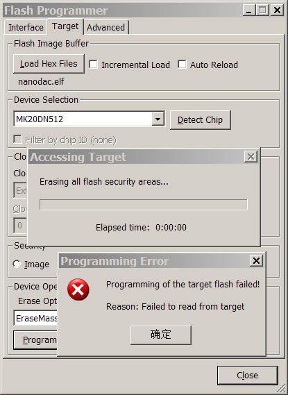

TOMXUE
Dear Pgo:
Thanks for the work on 4.10.6!
I have tried the version of 4.10.6, there is something not as good as 4.10.5.
When I try to program the K20DN512 with 4.10.5 and USBDM/SWD, everything work very well,
but when I change to 4.10.6, sometimes the program flash work, sometime it not.
The following is the error figure:
It seems that one time is work and the next time is not, but the third time is work again.
Many thanks
Tao Xue
2,719 Views
pgo
Senior Contributor V
Hi Tao,
Can you provide the following information and I will see if I can find a reason:
  • Operating System
  • What BDM you are using
  • What interface (SWD or JTAG)
2,719 Views
TOMXUE
Hi, Pgo:
I am using codewarrior 10.4 in windows XP with USBDM SWD for Kinetis K20 MCU.
Tao
2,719 Views
