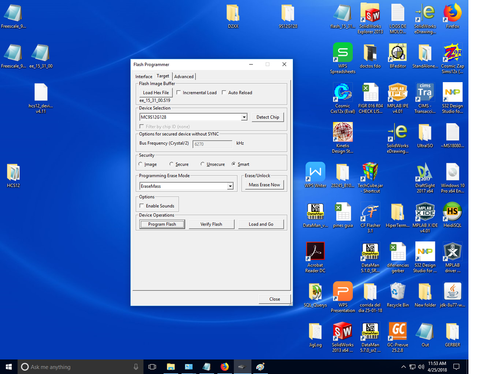

Hi pgo
I'm working with USBDM from Witztronics using WTUSBDM_CF_JM to program S9S12G128 but I have some issues for example when I tray to flash the memory program it says "Program data not within target flash memory" and the way I do it is fist program eeprom memory using erase mass option and for the flash program EraseSelective option.

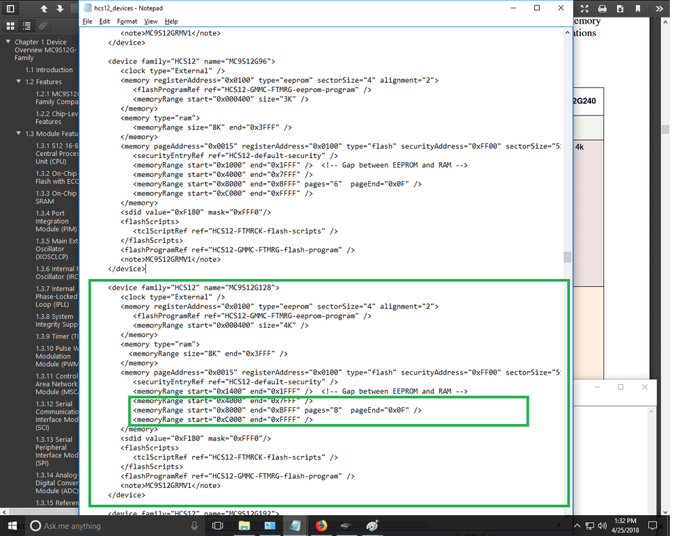

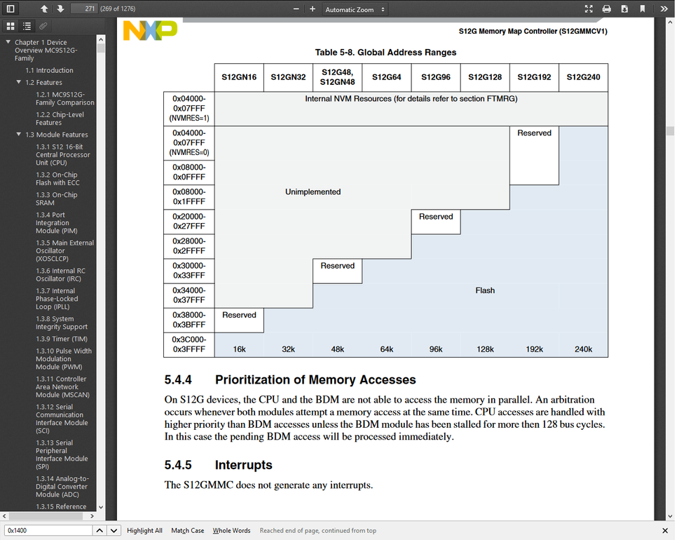

So I think it could be flash memory configuration issue because flash range start on 0x20000-0x3FFFF for S12G128 and hcs12_devices.xml and I don't see it where.

And the flash program it's correct because we use it with PEmicro and works well.
