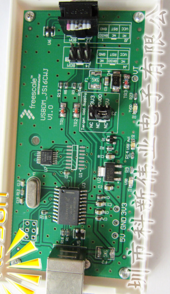

saif_14
:smileyhappy: Yes confirming that above USBDM is working with CodeWarrier 10.5.
After a long shipment delay, I received USBDM today. I programmed MC9S08EL32 and was able to debug too.
BDM firmware was 4.10.4 and DLL version 4.10.6.250
The build quality of the programmer was good.

saif_14
Thanks for looking into my query.
One inside image (attached) of the device indicates that it is based on MC9S08JS16CWJ.
In PCB it is mentioned  USBDM_JS16CWJ   V1.0.
Which means it is JS16 type right? so it might be possible to upgrade to latest USBDM and use with CodeWarrier 10.5?

pgo
Senior Contributor V
Hi Saif,
It would appear to be similar in functionality to the basic BDM described here (except without ARM-SWD features):
http://usbdm.sourceforge.net/USBDM_V4.10/USBDM_JS16/html/index.html
But this version is not current as it doesn't support Kinetis devices.
You should be able to debug HCS08, HCS12 & CFV1 devices as given in the table on this page (under USBDM_JS16CWJ):
USBDM: USBDM Debugger interface for Freescale RS08,HCS08,HCS12,Coldfire and ARM-Kinetis Devices.
Firmware updates are available.
