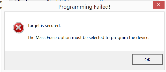

I've read the mcu flash without any problems. I wanted to write the file i had read into a new mcu, but it wrote in the first time. After that it started to display the fault message 'target is secured'. Even though i did a mass erase, i can't write anything now. Why is this happening?

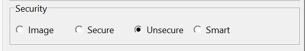

The security of the device is determined by the image and the security options selected in the programmer.  Did you select Unsecure before programming?

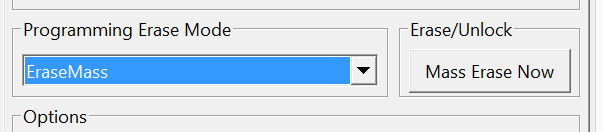

The Mass Erase Now button mass-erases the device.  A mass-erased XEP is secured since the security area is blank.  The Mass Erase Now button does not program the security area (to avoid wear on the chip).
You have to select the mass erase option for programming to a secured device:
I'm sorry the error dialogue is unclear.
Mass-erase is described here:
USBDM-Flash-Programmers: Flash Programmers Details
