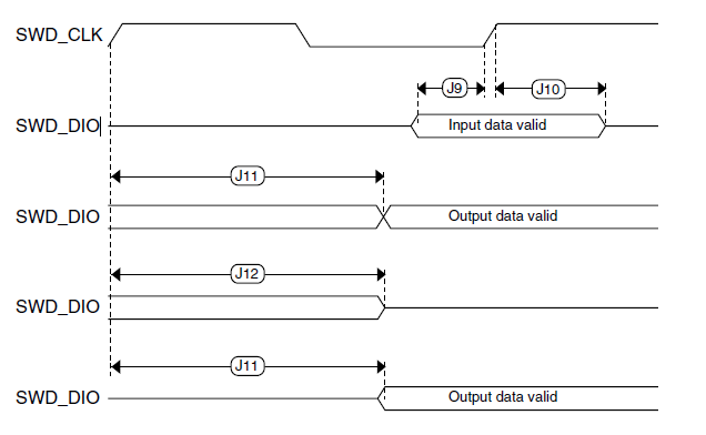

Joel69003
Hi PGO,
First of all, thanks for your answer.
Unfortunately, I get the second result :smileysad:
What mean the lines "rCreg r=0x1000004(MDM_AP.Control)->0x00000001" ? Is it possible that I have a hardware issue with my USBDM ? With the microcontroller ?
I had a look to the signals on the USBDM during the execution of the script. They look great, there is a clock signal on SWDCLK (about 2MHz) and some data on SWDIO.
PS: I already get some secured devices from Freescale in the past. It was some S08 devices, so unsecure is easy by pulling BKGD signal to the ground, but doesn't work with Kinetis devices... :smileysad:
Joel Guittet
11,634件の閲覧回数
pgo
Senior Contributor V
Hi Guittet,
If you have a look at chapter 9 in the KL05 manual (Debug) it describes the MDM.AP status and control registers.  The latter is the one being used to mass erase the chip.
:wCreg r=0x1000004(MDM_AP.Control)<-0x00000019  indicates a value being written to the Control register
:rCreg r=0x1000004(MDM_AP.Control)->0x00000001  indicates a value being read from the Control register
The sequence:
  1. # :pinSet 0x8
  2. # :wCreg r=0x1000004(MDM_AP.Control)<-0x00000019
  3. # :wCreg r=0x1000004(MDM_AP.Control)<-0x00000011
is asserting hardware reset (1st line) and then attempting to start a mass erase operation.
The sequence:
  1. # :rCreg r=0x1000004(MDM_AP.Control)->0x00000001
  2. # :rCreg r=0x1000004(MDM_AP.Control)->0x00000001
  3. # :rCreg r=0x1000004(MDM_AP.Control)->0x00000001
is polling the status register waiting for the erase to complete (waiting for bit #0 = Flash Mass Erase in Progress to clear).  In the first example Bit #0 clears almost immediately. In the second case it times out.
According to the manual (Bit 0)
Set to cause mass erase. Cleared by hardware after mass erase operation completes.
When mass erase is disabled (via MEEN and SEC settings), the erase request does not occur and the Flash Mass Erase in Progress bit continues to assert until the next system reset.
I believe this is the correct sequence to erase the chip and the only reason I know of for failure is that the chip has mass erase disabled.  However, it is very very unlikely that the chips you received from Freescale are actually in this state but at the moment I can't suggest any other possibilities.
You can try the following sequence to gain some more information from the MDM-AP.Status register.  This has a bit that shows if the chip is mass erase protected:
openbdm
settarget arm
source devicedata/arm/Kinetis-KLxx-flash-scripts.tcl
rcreg  $::MDM_AP_Status
massEraseTarget
closebdm
I would be grateful if you would post the result.
bye
11,634件の閲覧回数
Joel69003
Hello PGO,
I looked at the datasheet, but I'm a little bit confused.
First of all, here is the result of the script: MDM AP Status = 0x34
Note that I had to add "catch { connect }" to your script, just after calling "Kinetis-KLxx-flash-scripts.tcl".
Ok, so, according now to the datasheet:
- Flash Mass Erase Acknowledge bit (0) is not set.
- Flash Ready bit (1) is not set. By reading the description, I'm not sure this is correct...
- System Security bit (2) is set . Again, not sure this is correct...
- System Reset bit (3) is not set, indicating that the system is in reset. Is it normal ?
- Reserved bit (4) is set.
- Mass Erase Enable bit (5) is set, so it seems that mass erase is enabled.
I don't know really how to interpret this. I have no Kinetis device to compare the result.
EDIT:
- What is the SEC setting ? Is it System Security bit ?
- Another post with maybe quite the same issue: Re: Kinetis K20 - unable to debug. I have tried to force reset pin low but this make no difference. According to your Kinetis TCL script, this is what you are doing throw the USBDM.
Thanks for your help.

zqc
Hello PGO
Pleased to meet you,pardon me I am a poor English.
I want to design a off line programmer for MKL05Z32,but I am not clear how to use the SWD bus to access the FLASH.I have read "ARM® Debug Interface v5 Architecture Specification",but It's still very unclear to me.Please help me and give me some document
I am anticipating your reply,best wishes to you and everyone.
11,634件の閲覧回数
pgo
Hi zq,
programming is usually done by downloading a program to the targets RAM along with the data to program.  The chip then programs itself.
I'm sorry but it is quite a complex process in detail and not possible to describe simply.
You have to understand how to use SWD interface as described in the manual you reference and also how the flash memory is programmed.  The source code for USBDM is available if you want to look at how it works but again it is quite complicated.
bye
11,634件の閲覧回数
zqc
Thanks a lot
The USBDM (based on "USBDM_SWD_JS16CWJ.pdf" schematic) always change the data line on the clock failling edge(programming MKL05Z32),but the J-LINK always change the data line on the clock rising edge(programming MKL05Z32),and the "ARM® Debug Interface v5 Architecture Specification" is change the data line on the clock rising edge too.I don't know if it Bring some problems.Or we can make the target to get the data on the  rising edge or failling edge by setting Register or using special Timing.
ChenZaoqiang
                                                                                                                                                            此致
                                                                                                                                                                  敬礼
11,634件の閲覧回数
pgo
Hi zq c,
The SWD is based on JTAG protocol.  Input data is clocked on the rising clock edge, output data is appears on falling edge (so as to be valid on next rising edge).  However the only requirements have to do with the rising clock edge.
According to JTAG specs the input data to target should be valid a tsu before and thld after the rising clock edge. However, thld is usually zero.
I haven't had any communication problems so I would think the timing I'm using is correct.
I can't comment on what other interfaces do.
This seems consistent with the data sheets for the kinetis devices e.g. 6.1.1 JTAG electricals of the K20P48M50SF0 data sheet
or the 6.1.1  SWD Electricals of the KL05P48M48SF1 data sheet.
bye
PS.  Why are you posting on this thread?
